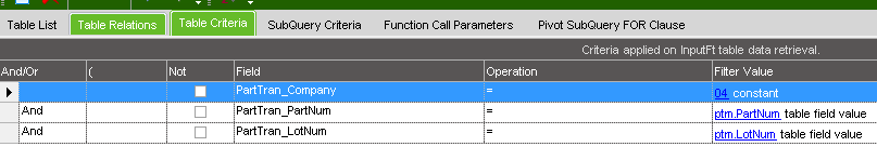

I just had to write this for a report. This gives you a running total per PartTran.TranNum for transactions grouped by company, part and lot. Also, I am not considering all TranTypes or Plants. The big thing that you want is the ROWS UNBOUNDED PRECEDING at the end of your statement.
SUM(CASE WHEN PartTran.TranClass IN (‘A’,‘R’) THEN PartTran.TranQty1 WHEN PartTran.TranClass IN (‘I’) THEN -1PartTran.TranQty END) OVER (PARTITION BY PartTran.Company, PartTran.PartNum, PartTran.LotNum ORDER BY PartTran.TranNum ROWS UNBOUNDED PRECEDING)
I have this in a Subquery in the BAQ and then join to the top level query by TranNum. I then apply a Table Criteria for the Subquery to filter the records to the top level records because WHERE’s are a lot faster than joins in all of my tests.
