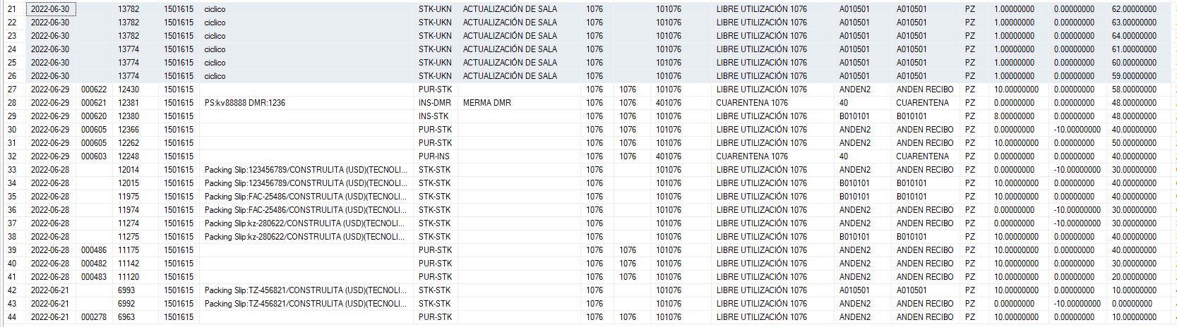

Create a BAQ to try to imitate the behavior of PartTranHistory. I follow the query in the post, but the running total doesn’t calculate correctly, but only in specific tran types.
This is the current return values (from right to left Running Total, Output, Input)

This calculation error doesn’t always appear

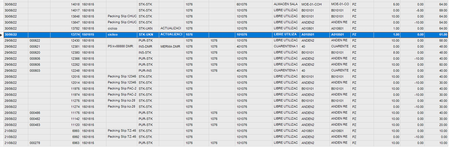

Is your issue that the highlighted transaction (STK-UKN) appears to be for a qty of 1, yet the running balance seems to adjust by 3?
yes, but I still don’t know what the problem could be, I think it must be something related to the partition but I found this, I even changed the query by adding the type of transaction.

it returns me the results in this way
Is that 3rd column the trannum? You shouldn’t be getting multiple copies of a transaction. Double check your joins to see why you’re getting some dup patrtran records
