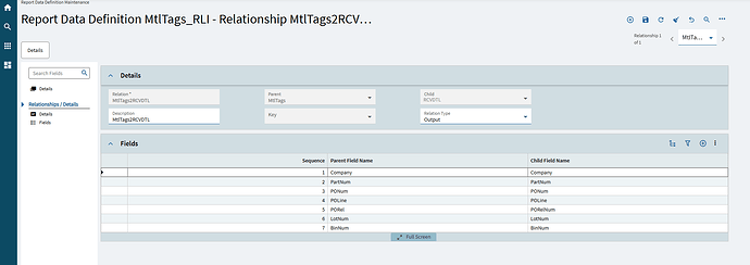

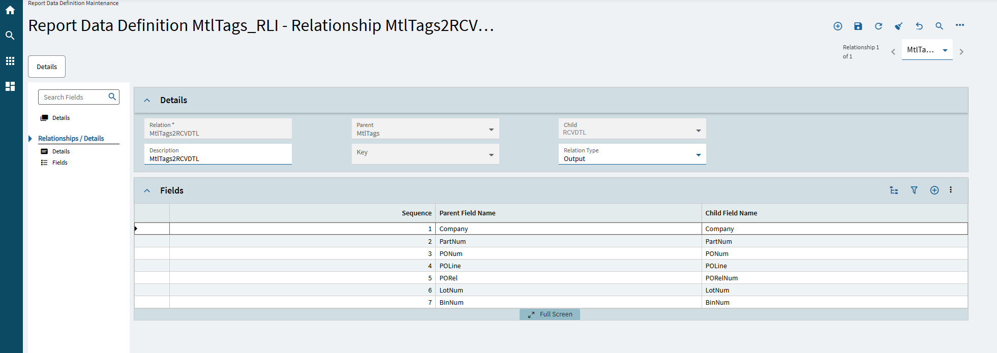

We are using the TranReference field to store our Lot Numbers for certain Parts in Epicor. We have also been implementing EKW and printing our own labels as they are being stored. We were able to get to the TranReference field and get it on our labels by adding a MtlTags2RcvDtl relationship:
However, after time has gone by, we have started to run into duplicate labels being printed. We found that this is because the MtlTags table doesn’t store PackSlip or PackLine in order for us to get the relationship down to that level, so if we have any other Receipts that have a line with the same Part, Lot, and Bin, we get duplicate records and labels.
