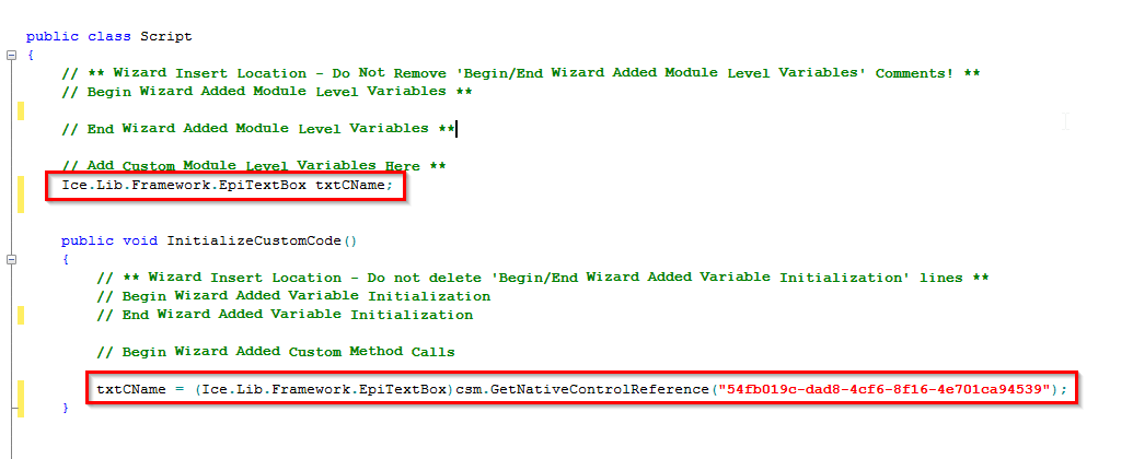

Here’s what i use to declare it. You’ll need to take the Guid from the control’s properties:
Then, you can use txtCName.Text = “some text”;
