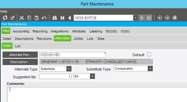

Why don’t use use the “Part Alternates” feature that is built into Epicor.
  1. define a “Substitute” with a type of “Comparable” for each part:

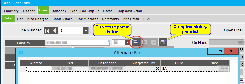

  2. THEN when in SO Entry, if there are not enough, you can press the Substitution button, and it will show a list of parts that can be substituted:
  3. note that there is also a “Complimentary” part feature where you can add additional parts to the order. These features are not used as often as they could be.

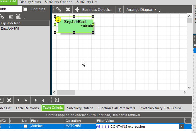

in your BAQ you can use the MATCHES and CONTAINS expression to look for matches. Probably make that part into a sub-query with the top level being the specific part number you are looking for.

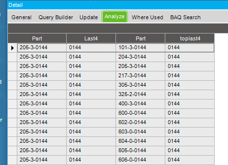

So after playing with this for while, one way that I figured out how to make that BAQ work is to make 2 subqueries, where they both have the part number, and a calculated field that removes the first 6 digits.
Something like this (just make #10 something longer than the longest part number you would have)
substring(Part.PartNum, 7  ,10 )
Then join by that calculated field in a top level. Add any other info you need into one of the one where you don’t filter the part number, and you should have all of the parts that match other than the first 6.

I think something like this would work. How can I get it to filter by what is entered in the orderdtl.partnum field?
It’s been a while since I’ve done a BAQ zone, so I would have to try one again, I thought that you pick one of the fields to filter by??? There has to be some way that it knows which field to look at.
Yeah, use the customization wizard to too add the zoneBAQ to the field. This an example of the code that will populate. I’m pretty sure you just need to make sure that your fields are “like” values are set. But I can’t remember for sure.
