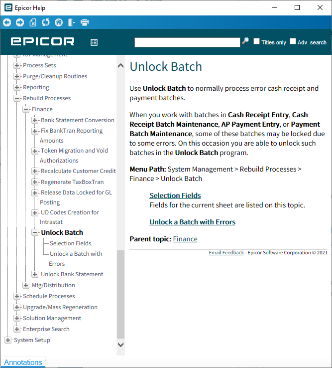

Payment is locked and won't post and I can't delete/void payment in any way
I am unable to post a payment that I had started. I printed the check, but I am unable to void the payment and start over or correct the payment at all.

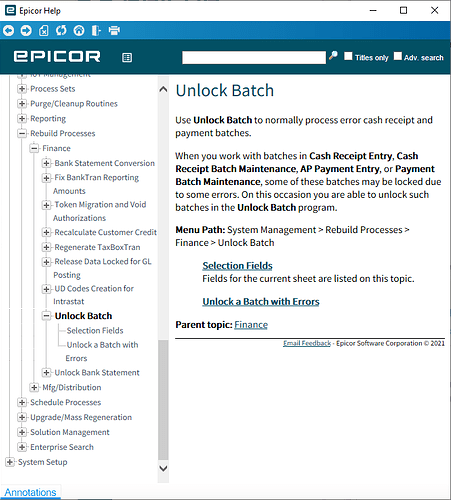

There is an Unlock Batch process, but I don’t know much about it. It’s an actual screen; it’s not buried inside Conversion Workbench or anything weird like that.
@Lynda You can get a data fix fro support that sets the check number to zero so you can delete it and start over. Or you make a UBAQ that could do the same process.
I am just now returning to this issue. We did get the fix to work on deleting the locked payment. Now it shows those invoices has open, but when I try to select them for payment it won’t show them as available.
There are a few KBs on invoices missing that point to the payment method being different that the current batch.
