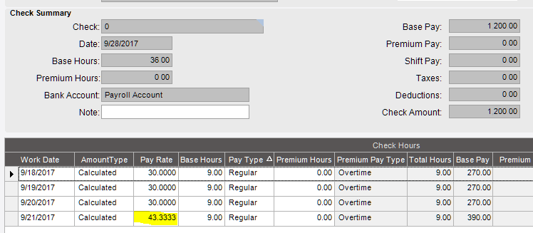

- I thought I could just delete the “make-up” record from the check and the system would recalculate a new rate for all of the records, like it does when it’s over 40. However, the system does not. Instead, it just changes the rate of the previous record to make the check equal $1,200. See images below.

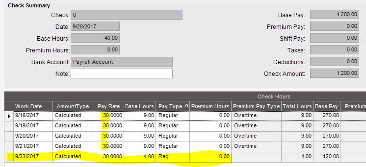

Highlighted records is the “make-up” hours, created by the system.
If I deleted the “make-up” hours, here’s what happens to the pay rate.
