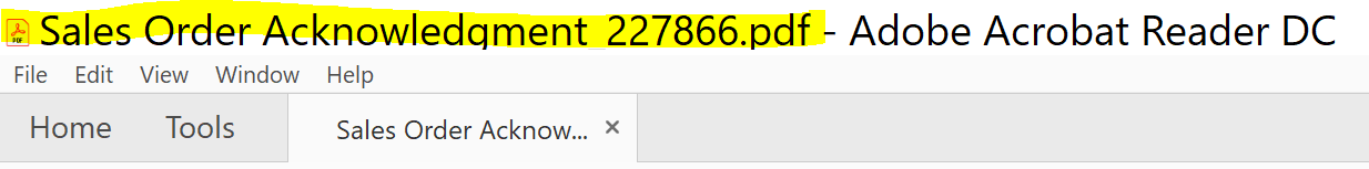

PDF Rendered File Naming
Is there a way to change this file to name to include additional data like Customer Names AND/OR Order Numbers?
I know it can be done with Break/Routing in email but curious if it can be changed for standard previewing and emailing via the interface.

Hello @rosshughes
This is the work-a-round that I use, if you want you can change the file path to a local drive on the user’s computer, and you can add different data to be included in the file naming… and you can also leave the emailing part out if you just want to save the file to a location
Final working code for generating a pdf with your own filename… and emailing it with Outlook
