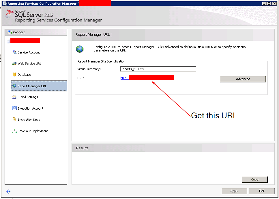

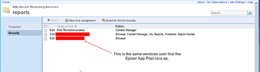

Lawson,
Not sure if this is the issue but might be worth checking. In our SSRS setup we have the user which runs the Epicor App Pool enabled to run reports.
To check…
  • open the SQL Reporting Services Configuration manager on the SQL server and get the URL for the Report Manager
  • open the report manager in IE. If I remember right chrome doesn’t work.

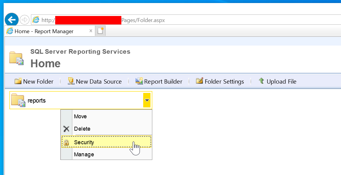

  • click on the reports folder and select security
  • Check to see if the Epicor App Pool user has access.
Brett
Thanks Brett,
The problem I’ve got is, the people that set out Epicor up originally, the user that they created for the App Pools isn’t a Windows user,
When I go to put that user name into the security settings it says “The user or group name ‘print’ is not recognized.”
@bmanners , I’ve added the user to the domain and added it to where you mention above, I’ve also added a domain group to the Report Services that include all of our Epicor users… still no go :frowning:

That’s a simple setup. I expect the code will be running as the local user so I guess we want to check if the local user has access.

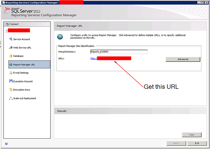

Can you run the report through the report manager URL? To do this I run the report in Epicor (set archive period to a week) then grab the GUID from the task monitor and paste that into SSRS. I can explain in more detail if you are not familiar with this trick.
Can you output the defaultCredentials that the system is pulling to a message box just to check?
It is also possible to hard code in the username and password (I had that for a while). I don’t have the exact syntax handy but it is possible. You could hard code in your credentials as a test.
last thing I notice we also have “everyone” with the browse role in SSRS on the base folder. You said you added a domain group with the Epicor users in it so I expect that should be enough…

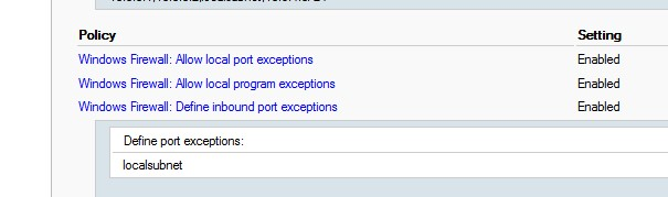

Finally got it working… I made a couple of small changes to the GPO and it started working
Fantastic! do share what the secret trick was?
I made a couple of changes but I think the one that did it was “Allow local port exceptions”

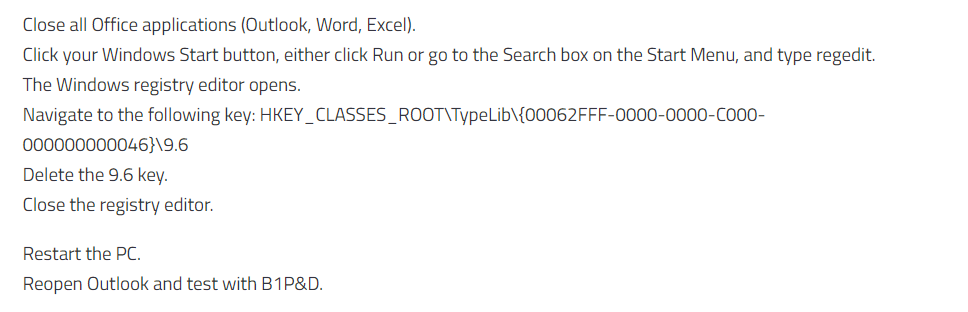

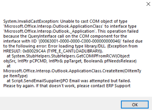

Hi @LBARKER @bmanners
I am getting errors in the below line.
Outlook.MailItem oMsg = (Outlook.MailItem)oApp.CreateItem(Outlook.OlItemType.olMailItem)
Dear All,
It’s working. if we do the below steps working.,
