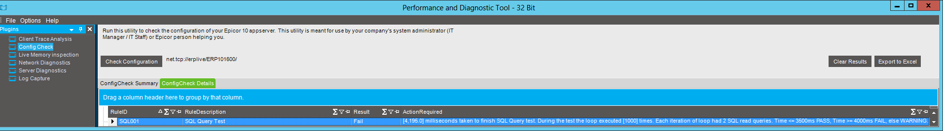

Hello,
I’m running the PDT Config Check against my E10.1.600.16 database and I’m getting a FAIL on the SQL001 - SQL Query Test.
(First of all, a warning that this line item doesn’t seem to highlight in RED like the others so it was hard to see at first.)
This is the message I’m getting…(no laughing please :blush: I probably have some serious performance tuning to do)
[4,195.0] milliseconds taken to finish SQL Query test. During the test the loop executed [1000] times. Each iteration of loop had 2 SQL read queries. Time <= 3500ms PASS, Time >= 4000ms FAIL, else WARNING.
I’ve looked in the PDT Help and Performance Tuning Guide and EpicCare and E10Help.com but I can’t seem to find anything that points me towards the things I need to fix/adjust/modify to get this test (and I’m assuming ultimately my server and E10.1) to perform faster. This server is Virtualized with VMWare if that matters for this test.
Thank you for any help and guidance you can provide!
-Heather :slight_smile:
