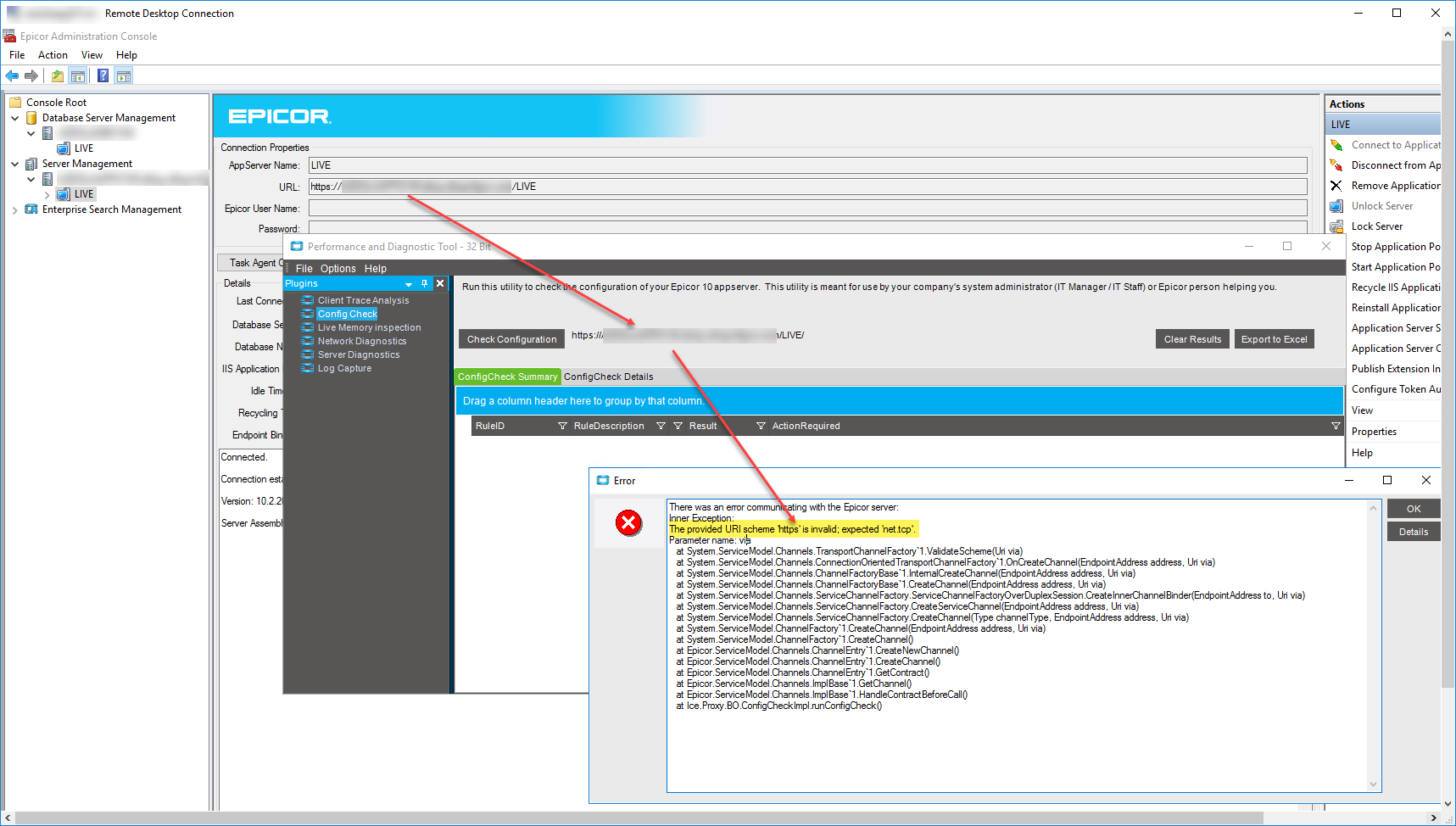

Why can’t I use the PDT with the HTTPS binding?
It says it expects a net.tcp, but if I switch it to that, it spins for days (we didn’t deploy net.tcp).
Do I have to configure my app server to have the net.tcp binding in addition to HTTPS before I can use the PDT on it?

What if you try to use net.tcp and just change your Connection Method? or perhaps use HTTPS and check your Connection Method.
Wow.
Yup. That did it.
