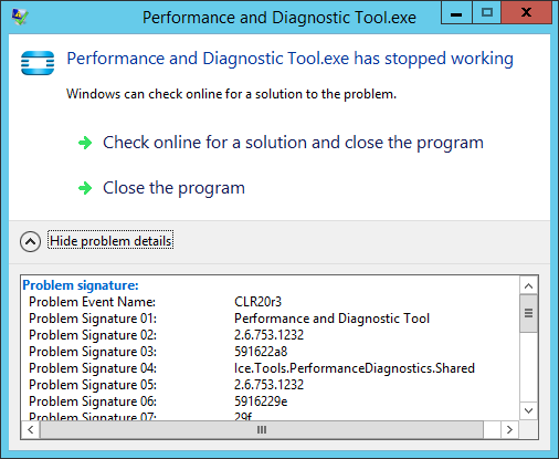

After installing PDT from the Epicor Administration Console (EAC) i get the following error:
Cause and Solution:
The folder, PDT10 at %UserProfile%\AppData\Roaming\Epicor Software\ needs to be deleted before you start the Performance Diagnostic Tool.

  1. Tried loading the PDT on a laptop with Windows 10. The first install works as it should. When the PDT is closed and reopened no error is displayed at all and the program doesn’t execute.
  2. Installing .NET 4.7 doesn’t correct the issue.
  3. Uninstalling and reinstalling .NET doesn’t work.
  4. Deleting files in %temp% has no effect.
  5. deleting all .cch in %UserProfile%\AppData\Roaming\Microsoft\CLRSecurityConfig2.0.50727.312\security.config.cch and C:\Windows\Microsoft.NET\Framework \2.0.50727\CONFIG has no effect.
  6. Uninstalling PDT with Revo, and reinstalling has no effect.

I thought I would share this with you all in case this happens to anyone else. This took hours to figure out why I couldn’t use PDT any longer.
The last time I used PDT successfully was when I was setting up our Production Application Server and I was using PDT to troubleshoot the server configuration and some issues with the Sales Configurator in 10.1.500.x. Since then I have upgraded to 10.1.600.22.
The solution is as follows:
Delete the folder PDT10 at %UserProfile%\AppData\Roaming\Epicor Software\ needs to be deleted before you start the Performance Diagnostic Tool.
In 10.1 its E10PDT
