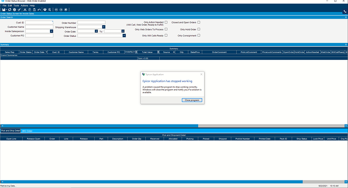

I asked the rep if he’s observed any patterns: what he’s usually doing when a crash occurs. He noted he’s usually entering order lines. Late last week, he was 20 lines into entering an order when Epicor crashed, and he had to do it all over again.

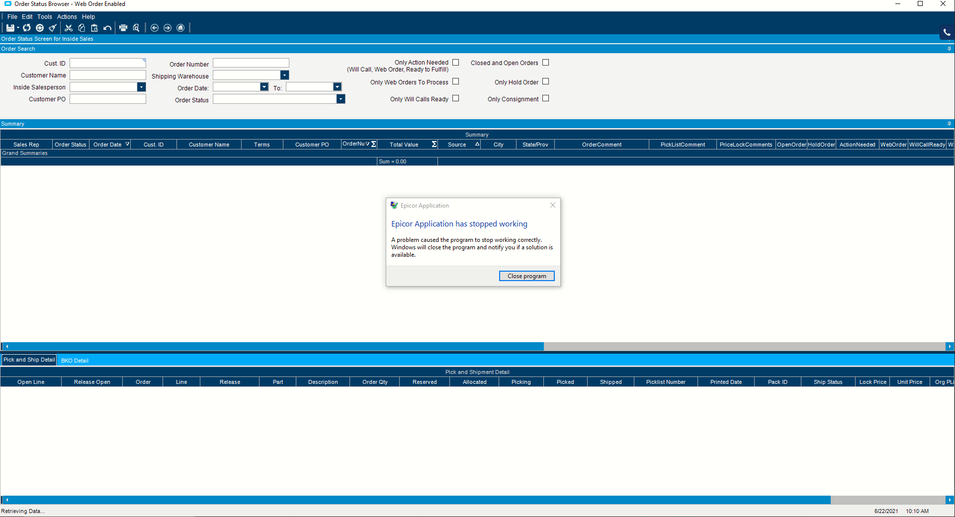

P.S. Apparently, he was using Order Status Browser (not Order Entry) when he took the screen shot he sent me, copied below.

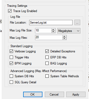

Do you have serverlog on? I run Verbose, BPM and detail exceptions, so I can go back to the server and find the log to check. You will have to calculate your time to UTC :slight_smile:

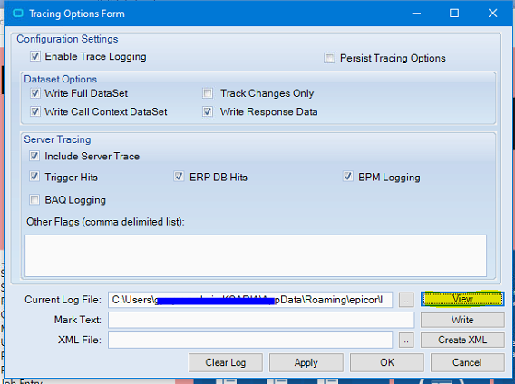

If you turn on tracing
I suppose that’s what Enable Trace Logging must mean, right?
I’m afraid I don’t know. Where can I look this up? :grimacing:

I have always done tracing from the client side and viewing the file from there. It is the icon next to developer in the interface you are using.
image001.pngIn Shell at the bottom
If I am programming then I do clear log – apply then trace and view, so I have this open a lot. You may want to do that with this user so you only get the sales order entry entries. For some users I will just leave it on all day.

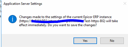

Appserver setting are in the Admin console. The ServerLog.txt file is made in the inetpub\wwwroot[Server Name]\Server folder
It will popup a warning. It does not have any impact on users.
