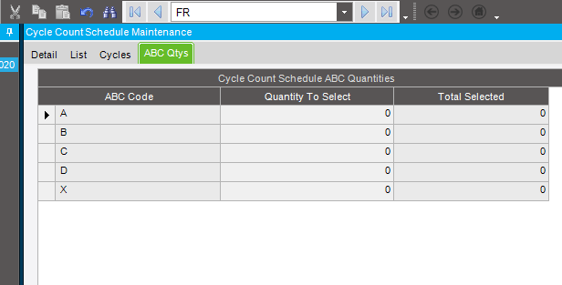

We did a physically inventory outside of EPICOR. Is there a way to reset the Last CC Date? We updated in test environment the value, but when we tried to do a cycle count, no parts were selected.
I did Initialize CC.

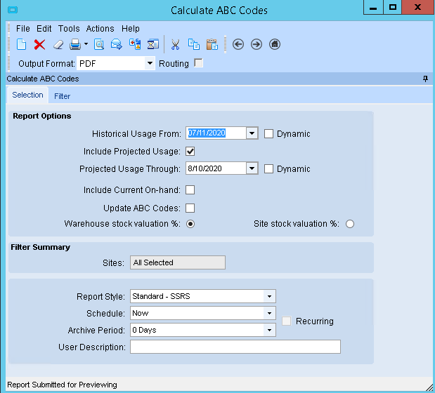

You do not have ABC Codes setup and populated. There is a program called “Calculate ABC Codes” that must be run.

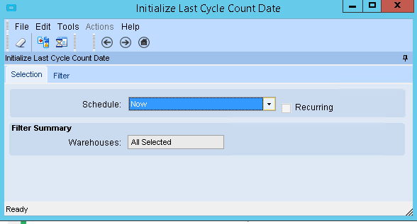

you have no last cc date set. There is a program called “Initialize Last Cycle Count Date” that will randomly set the Last CC Date. Note that this program will NOT work if you have not completed step 1 above.

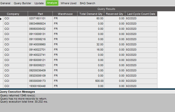

Even though it is a DB field, DMT does not have that field as a selection. We have a BPM that will update the record.
Thanks for the reply. We understand the whole process. Issue is that we updated the LAST CC DATE through a BPM, ran Calculate ABC’s, Initialize Last Cycle Count and nothing is showing up. I am using a small warehouse that we count in less than a day.
