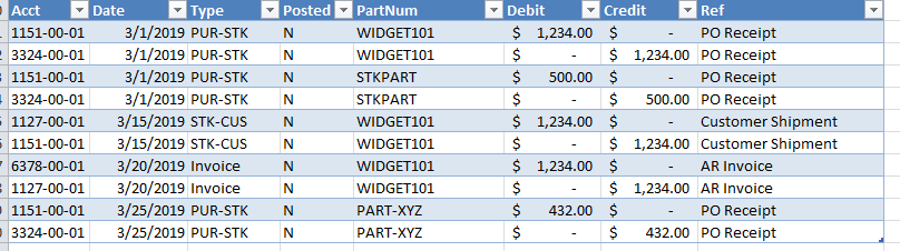

For example, take the following WIP/Recon report results
That shows 5 transactions (3 PUR-STK, 1 STK-CUS, and 1 AR Invoice).
(There are 10 lines because each tran has a line for the Debit, and another line for the Credit.)

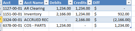

The summary combines the debits for each account and Credits for each. And results with:
So instead of a GL Line for each tran, it would make a GL Tran with just 3 lines for accts 1151, 3324, and 6378. And it only creates a single Credit or debit bassed on the difference of the summary. Form the summary above,
- 1151 (Inventory) would get a $932 Debit (2,166 - 1,234)
- 3324 (Accrued Rec) would get a $2,166 Credit (0 - 2,166)
- 6378 (COS - Parts) would get a $1,234 Debit (1,234 - 0)
Note that the total of the debit equals the total of the credits

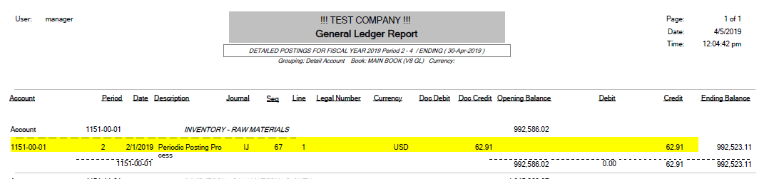

After the Capture COS/WIP is posted, the GL Report would show a rather cryptic “Periodic Posting Process”. This is the net of the summary for the specific account

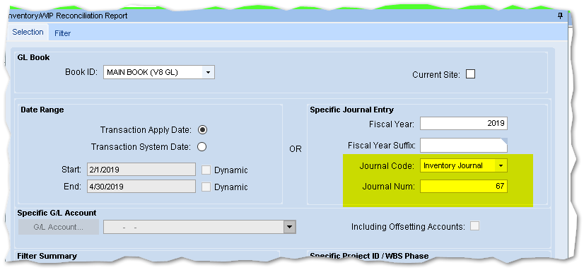

While this looks like you’d have no way of determining which transactions the “Periodic Posting Process” was for, you actually can. By using the WIP Recon report and entering the Journal Code and Number:
The resulting WIP Recon output will show all the trans that used in the GL Entry.
