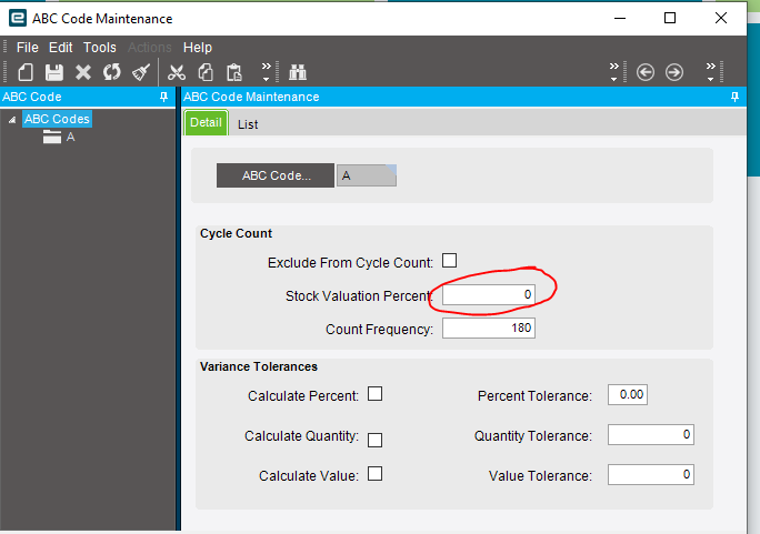

I am setting cyclc counting up. I have a question about the ABC codes. Can i set them up by Product group? Or does it have to be by the activity of the parts?
Out of the box, ABC codes must be set at the Part level… specifically at the Site or Warehouse level within Part Maintenance.
ok that was what i thought too but then reading up on it i was confused about this on the ABC code set up
When you allow the system to assign your ABC codes, it uses that value to determine which parts to assign this specific code to. These are done sequentially… for example you might want your “A” parts to be the 80% of your inventory valuation; your “B” parts to be the next 15%, and your “C” parts to be everything else… so “A” would have a Stock Valuation of 80, “B” of 95, and C 100.
