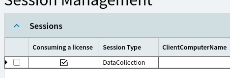

Opening MES in the browser first still, well, if you know you know…
Ice.BO.SysMonitorSvc/GetMonitorDataKeepIdleTimeaccess is now a breaking dependency in the browser. If it can’t connect, the client will exit.The good news is, it’s not transferring the entire contents of all notification history every 30 seconds any more. Look, an optimization!
[edit] Spoke too soon. After a little testing, this still isn’t fixed. Drinking from the firehose is now required.
