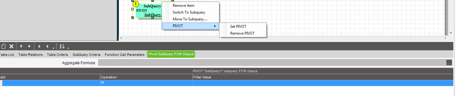

Hi Calvin,
If you make that query an inner subquery and then call it as a subquery you can pivot the values.
Unfortunately, you have to predefine the pivoting filters. One workaround I have used to make dynamic pivot tables is exporting the raw data via REST to excel and then doing the pivoting there.
