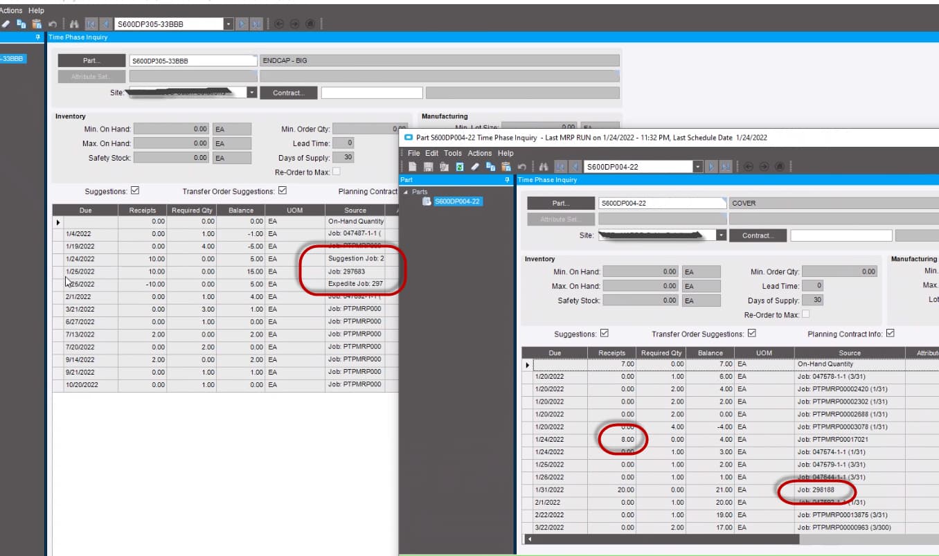

We have some parts that are not creating jobs suggestions to move the date but is instead creating a new MRP job. All Part Plant settings are the same for each of these parts.
Any thoughts where else to look what would cause this?

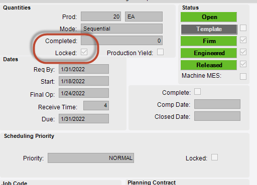

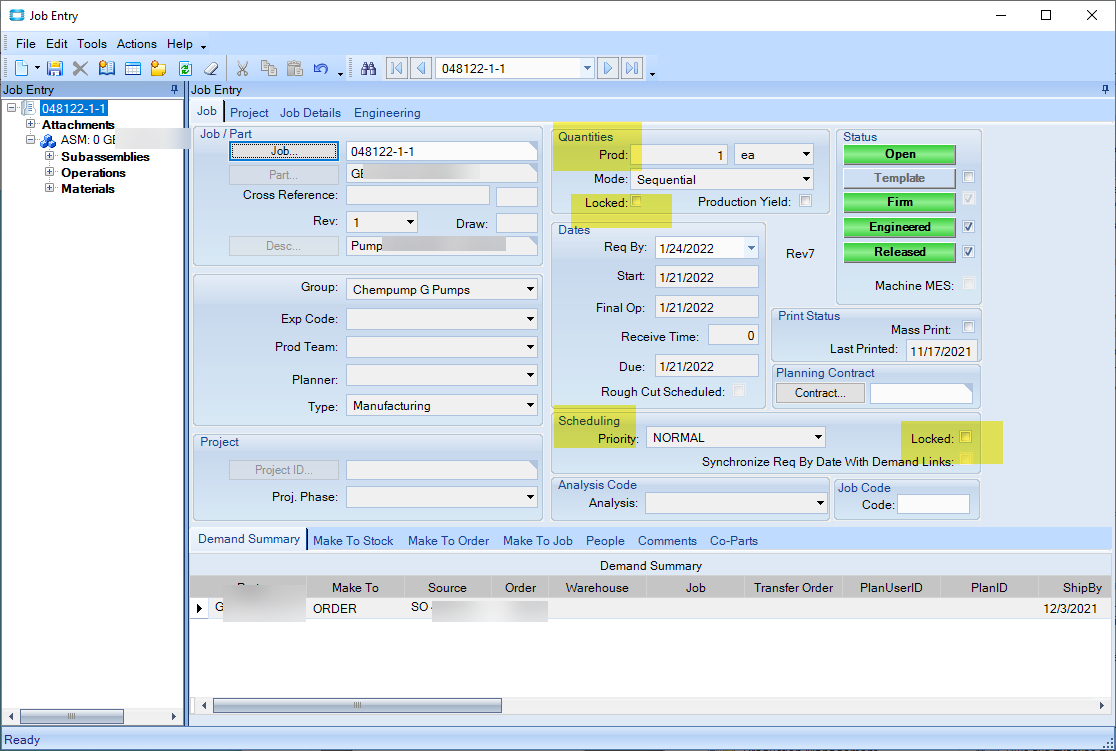

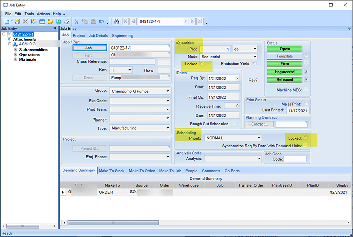

When jobs are checked for Lock Quantity you won’t get any suggestions to increase or decrease quantity. When jobs are checked for Lock Schedule you won’t get any suggestions to expedite or postpone job. Any chance you have some jobs with schedule locked and some not?
Nancy
Quantity was locked but Date wasnt. i wonder if that caused it not to suggest a date move because it also needed to increase the job by 8
