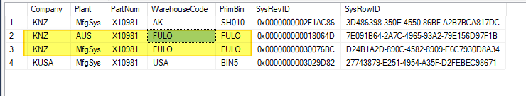

In one of our companies we have two sites, the main site MfgSys has multiple warehouses, the other site (AUS) has a single warehouse (warehouse code FULO). MfgSys does not have a warehouse FULO.
but… erp.PlantWhse is showing (for many parts, just looking at a single part here) that warehouse code and bin associated with both sites?
It looks to me like we might have screwy data here? (We are still pre-production, building pilot type databases. I have a suspicion parts were put into stock when the warehouse was under the main site, and then the warehouse later was moved to the AUS site… but I wasn’t involved with this)

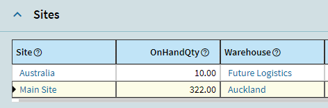

When i look at stock level in the Part module, under Sites tab, I’m seeing confusing data, eg:
so looks like 332 parts total.
But if I click on each Site in turn i see:
Australia (shows nothing):
Main Site (shows the Austalian FULO stock):
shows total 322, so is my total stock on hand 322 or 332?

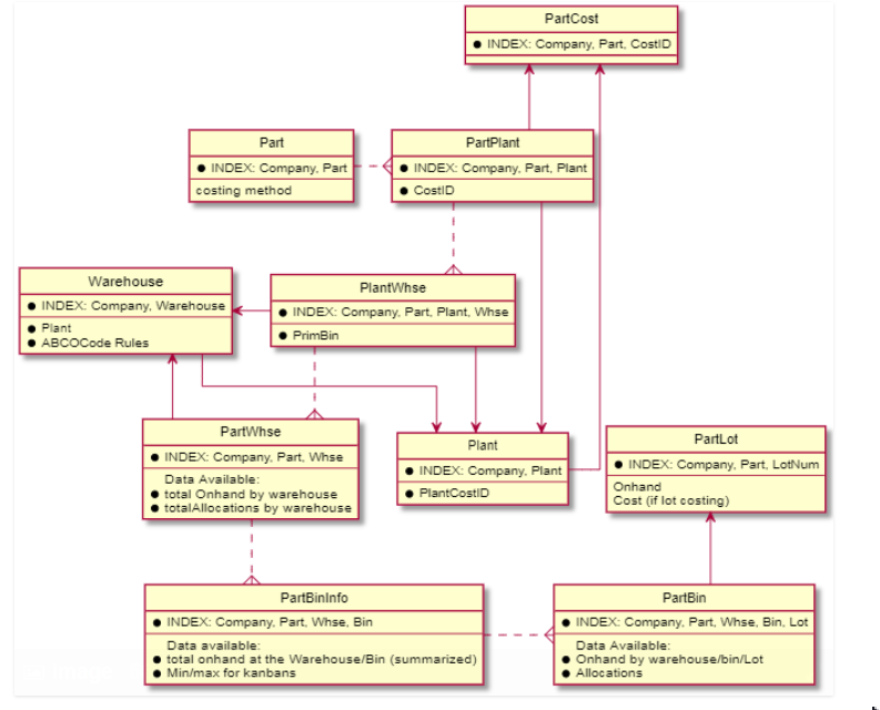

I found a useful entity relationshsip diagram from @timshuwy here Documentation via PlantUML - #2 by timshuwy but the post context was more about the diagramming tool than the diagram content.
I’m confused about how these tables interact and what their function is , esp PartWhse, vs PlantWhse.

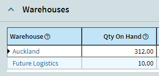

It appears when I actuallly go into sites that all the stock belongs to main site, with 312 in the AK (auckland) warehouse, and 10 in FULO warehouse, and that the au site has no stock of its own, so 322 is the total “stock”?
I’m not sure how that functionality works, I just thought that might explain why the part was showing in both warehouses in the DB.

PlantWhse facilitates the feature of Shared Warehouses and defines the relationship between the PartPlant table and the Warehouses in the Company (Site Configuration > Inventory > Shared Warehouses). If Shared Warehouses are enabled or not then the Plant that the warehouse belongs to is defined by the PlantWhse table.
Data Dictionary Table Description:
Warehouses associated with a Plant via a part. Needed since Plants can share warehouses and the Primary bin may be different for the same warehouse for different plants.
At least one PlantWhse record will exist for each record in the PartPlant file.
But notice that the Warehse table, nor the PartWhse table contain a Plant field to define which Plant the Warehouse belongs to, this is done with the PlantWhse table. It’s best practice to link through the PlantWhse to Warehse, PartWhse, PartBin, ect. If you don’t you can get incorrect data in BAQs.

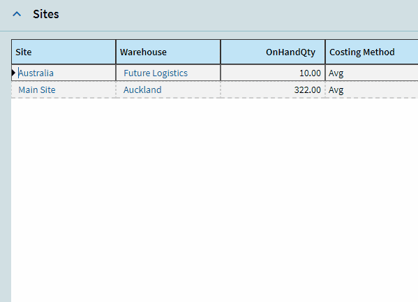

What I think I have seen is that when I look at the aucland site its including the stock in the australian shared warehouse. I can live with that once we understand that to be the case.
ie On the Sites tab the actual On-Hand qty across both sites is what is shown in Auckland (322, being 322 in Ak warehouse and 10 in AUS site’s shared FULO warehouse).
And if I click on the auckland site I can see that spelled out.
But why when I click on the australian site does it show no warehouse containing this part?
(This is from Part Tracker, no customization)
