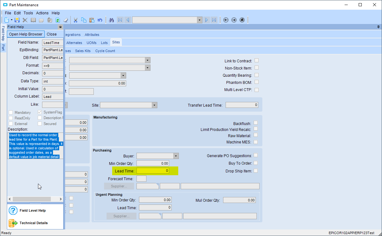

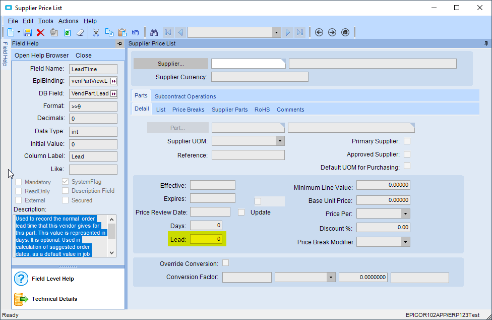

" Used to record the normal order lead time that this vendor gives for this part. This value is represented in days. It is optional. Used in calculation of suggested order dates, as a default value in job material detail records.
" Used to record the normal order lead time for a Part for this Plant. This value is represented in days. It is optional. Used in calculation of suggested order dates, as a default value in job material detail records.

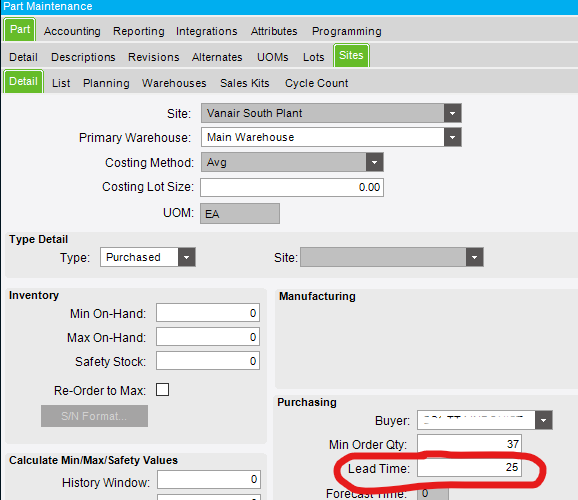

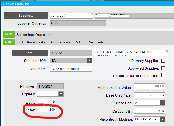

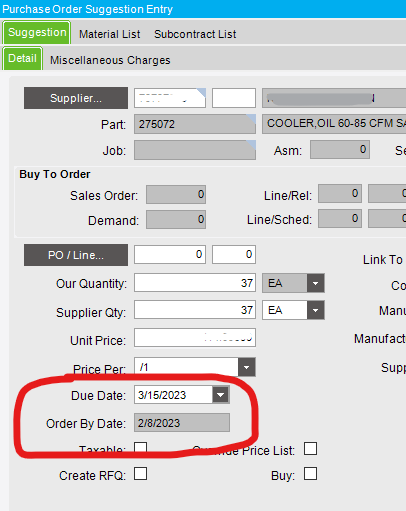

I know I’m late to this thread but it feels like the right place to add some more context and ask a question. We are (like everyone) experiencing many difficulties with supply chain. One thing I’ve been asked to do is review “actual delivery days” vs. “lead time” in the system and then make recommendations on which parts we need to update. I’ve found that a part plant record will show 25 days, for example. The supplier price list for that same part will show 100. But the PO suggestions are driving to 25 days. This seems to go against the logic described in this thread. See below for screen shot examples:

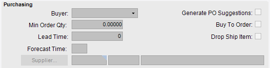

You’re not showing it in your screen shot (cut off at Forecast Time) but do you have the supplier listed in the Site?
Sorry. Yes, it’s the same supplier listed there as on the supplier price list. I think I’m figuring it out… but I’m re-running my Generate Suggestions in our Pilot environment. I think that the Supplier Parts tab Lead Time prevails over the Detail Lead Time in Supplier Price List. In this case, the Supplier Parts tab Lead Time is 0, which then forces it to use the Part Plant lead time… But I’m confirming my suspicions by re-running Generate Suggestions. Does that sound right?
Confirmed.
