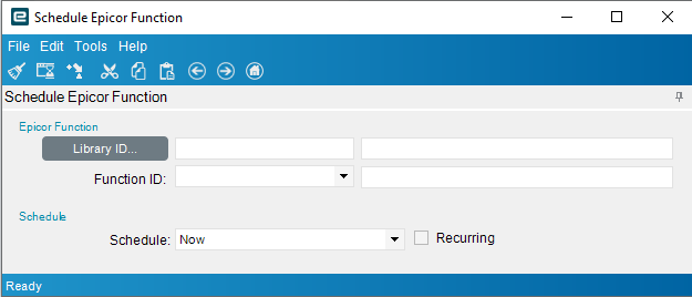

I’ve used the internal function scheduling for testing:

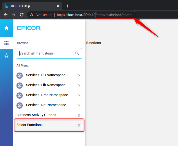

I can’t remember how long ago it was changed/introduced but from the /apps/resthelp page it’s been super easy to test published functions for quite a while now. It does add a couple of quick steps to the test process which is not ideal but I have still found it fairly easy and quick.
When a Kinetic UI version Epicor Functions UI is available, I suspect that it would be easy for Epicor to add test functionality directly into the development UI for a better workflow/experience but I don’t think that it would work well as well in, or would be worth adding to, the classic WinForms UI. Particularly when considering the DataSet input/output options.
