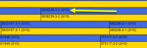

That is super helpful. I scanned through that - does the bar text get updated with the ToolTip or is that just a tooltip that appears when hovering? My main goal is to update the text on the “TimeItems” I think is what they are called. By default, it shows me a job # and something in parenthesis.
I honestly don’t remember Dan this was a code snippet from 2020 that I had laying around.
No worries. I’ll plug it in and see what happens. Thank you so much!!
No worries come back and update us, I know I did successfully add columns and changed tool tips etc but it was so long ago.

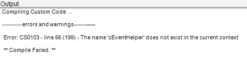

Almost there. I think there must be a helper file referenced… is there something you can share from that to help this thing compile?
Ah that’s another code snippet I’ll find it for you, here you go. Again Really old code snips so use at your own risk

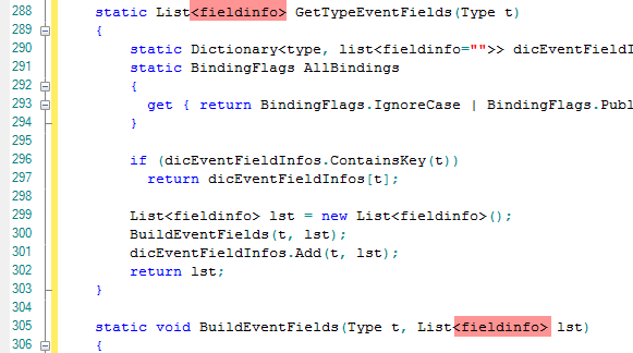

Sorry - still not quite there. Now I’m getting this error and I feel like it’s a silly one that I should be able to figure out but after about 20 minutes now, I’m not finding it. Any help for this?
Its FieldInfo (cammel case) from System.Reflection.

                object idx = fi.GetValue(obj);
                Delegate eh = static_event_handlers[idx];
                if (eh == null)
                    continue;
                Delegate[] dels = eh.GetInvocationList();
                if (dels == null)
                    continue;
                EventInfo ei = t.GetEvent(fi.Name, AllBindings);
                foreach (Delegate del in dels)
                    ei.RemoveEventHandler(obj, del);
            else
                if (ei != null)
                    object val = fi.GetValue(obj);
                    Delegate mdel = val as Delegate;
                    if (mdel != null)
                        foreach (Delegate del in mdel.GetInvocationList())
Thank you @josecgomez and @klincecum. I’m not all the way there yet but I am past the silly errors. The camel case thing has gotten me before. You’d think I’d learn.
Now I have to figure out how to make it work. I see no difference in my Multi Resource Scheduling Board.
