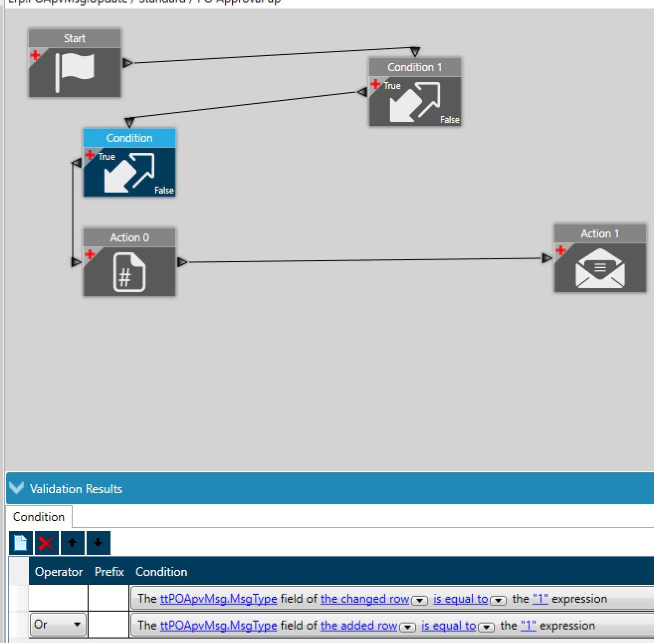

Here is an example I’ve built onto POApvMsg.
Please ignore the first condition as it just ignores a certain group.

We have messages sending to the original user when the PO gets its final approval. It uses the same custom code but with the condition being “2” instead of “1”

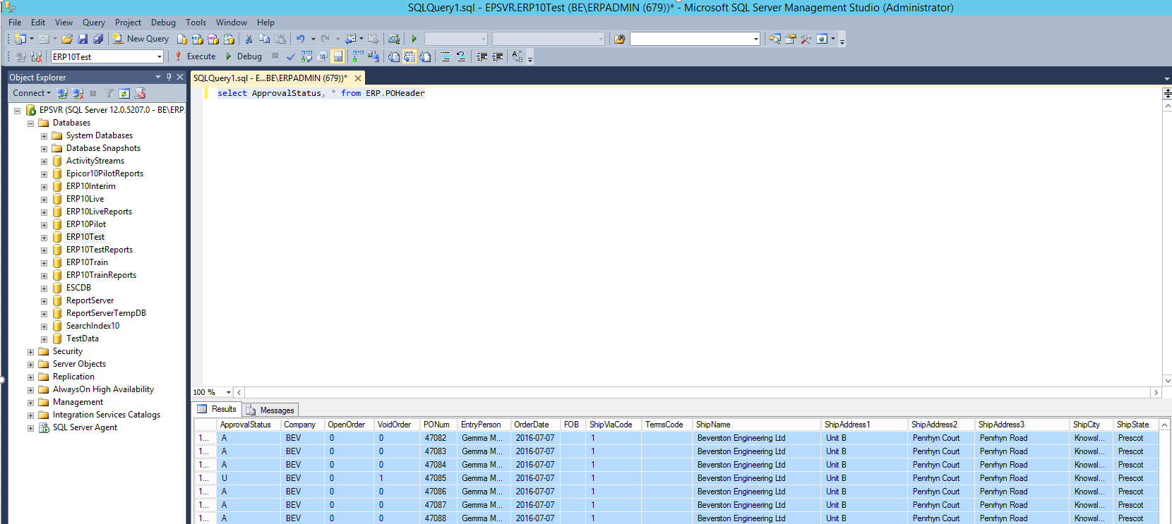

I am running Epicor 10.1.400.20 the only value for ApprovalStatus is “U” for unapproved PO and “A” for approved onse, so without looking to your way of constructing your BPM, if i were you i will go around the “P” value problem, by changing the “P” condition to be ApprovalStatus field equal “A” on post-process ChangeAprroveSwitch method, and that is it.

Yes you are correct. ApprovalStatus on 10.1 seems to be stucked at “U”. hmmm… I will try your suggestion and let you know.
