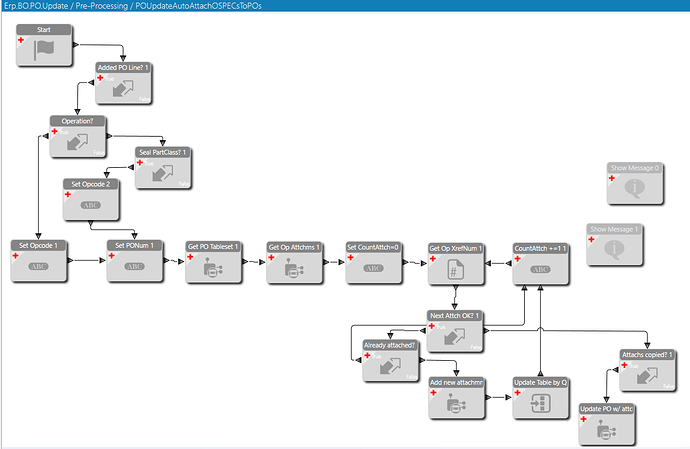

I’ve got (non-docstar) attachments copying from Operations to POs.
It’s a little tricky as it handles multiple attachments from the same operation, triggered by the PO line, but adds them to the PO Header. And makes sure no duplicates.
