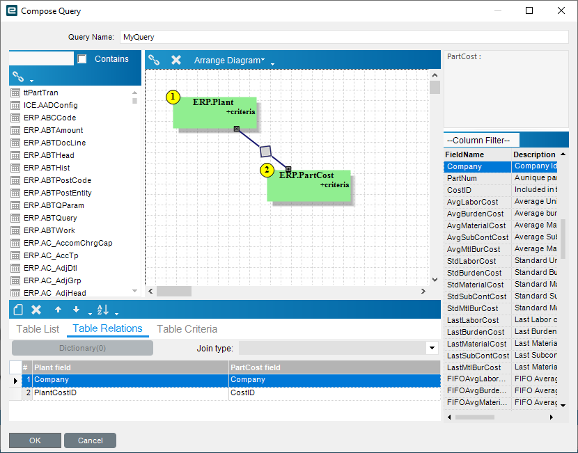

  3. “The” Standard Cost is not a thing. You have to ping the Plant table to get the active CostID for that site. I get it, today you only have one. But you won’t always…

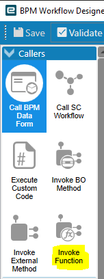

An EFx is essentially the middle part of a BPM (or some other proportion). You’ll see it looks immensely familiar.
But you can test it in Postman by giving an input and output.
Once you see it’s working, reference it in your BPM. The BPM just becomes a trigger. All the code can live in the EFx.
Once made, it’s a widget in the BPM:

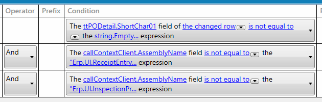

Data Directive on PODetail
Condition so it does not run from Receipt Entry or Inspection Processing.
custom Code in In transaction, but running Async, so you can check the exiting data versus the new data.
