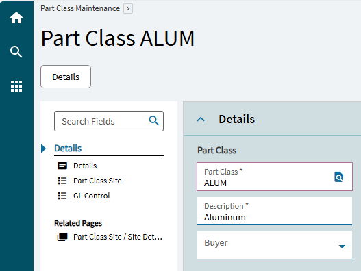

Is it assigning the buyer based on Part Class and then the default if none given?
I hadn’t looked there! The buyer for the part class is long outdated, and has been inactive in the system for years. It must be defaulting to the default buyer since this once is not active. Thanks!
Once I added myself as an authorized user of the default buyer. I could see the po suggestions.
