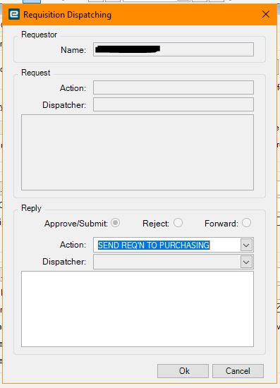

  2. Dispatch the req so it says approved.

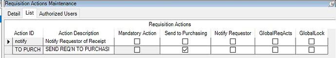

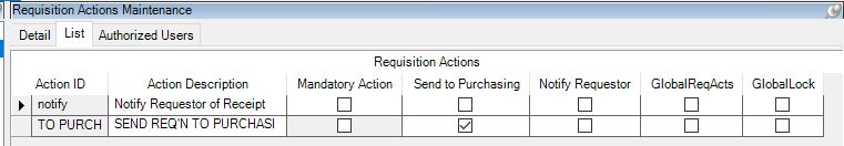

Did you set up Requisition Actions?
How are your Requisition Actions set up? in step 2 what does the approval screen look like?
The final action you take in the Dispatching screen should be the action marked as “Send to Purchasing” in Requisition Actions setup.

These two req actions were setup before I started. Clearly they are not in use now.

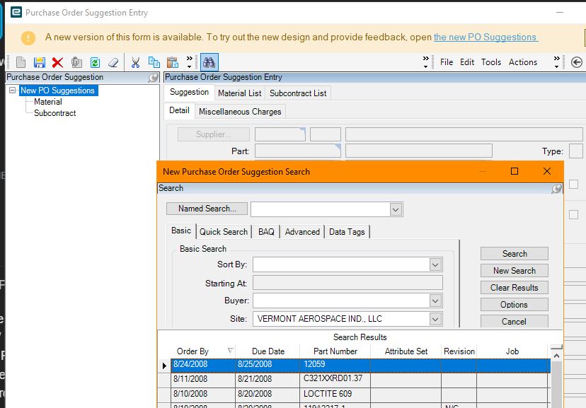

Jus to be sure.
Actions / New PO Suggestions
Window Pops up. “Purchase Order Suggestion Entry”
Press the binoculars.
“new Purchase Order Suggestion Search”
Press Search button.
Confirmed:
I do not see my recent reqs.
