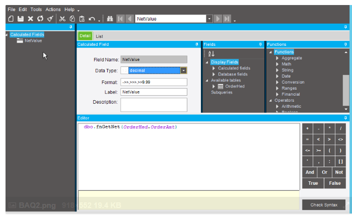

Just for showcase here is another way to leverage Functions, if you ever need to repeat some tedious Formula over and over and over again. Again dont use this for non-trivial formulas, just more dependencies to juggle during upgrades.
This used to work, not sure if it still does.
That’s it for my passion for the tool :smiley: I better stop showing all the tricks, many picked up from @josecgomez, before @pferrington considers them a risk in the cloud and patches them all :smiley:
Hey Patrick I used to be able to free form the table and set it as a Peer or Temp Table in 10.1.500 and I could make a BAQ pull IM Tables :smiley: whyd you patch it :poop:
Well, unless you know how to create function in the cloud database, personally i don’t see it as cloud problem :slight_smile:
Also scalar functions are not good for performance either
