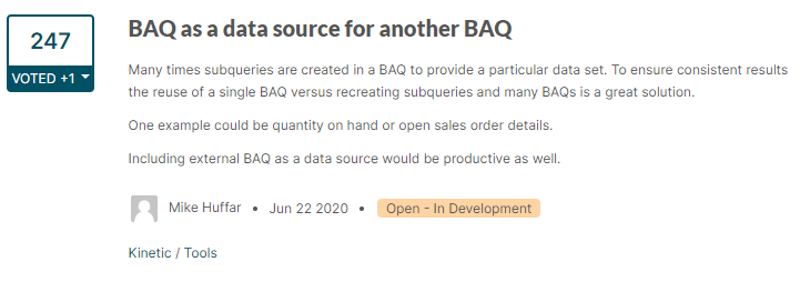

This here will help a bit in the near future :slight_smile:
https://epicor-manufacturing.ideas.aha.io/ideas/ERP-I-158

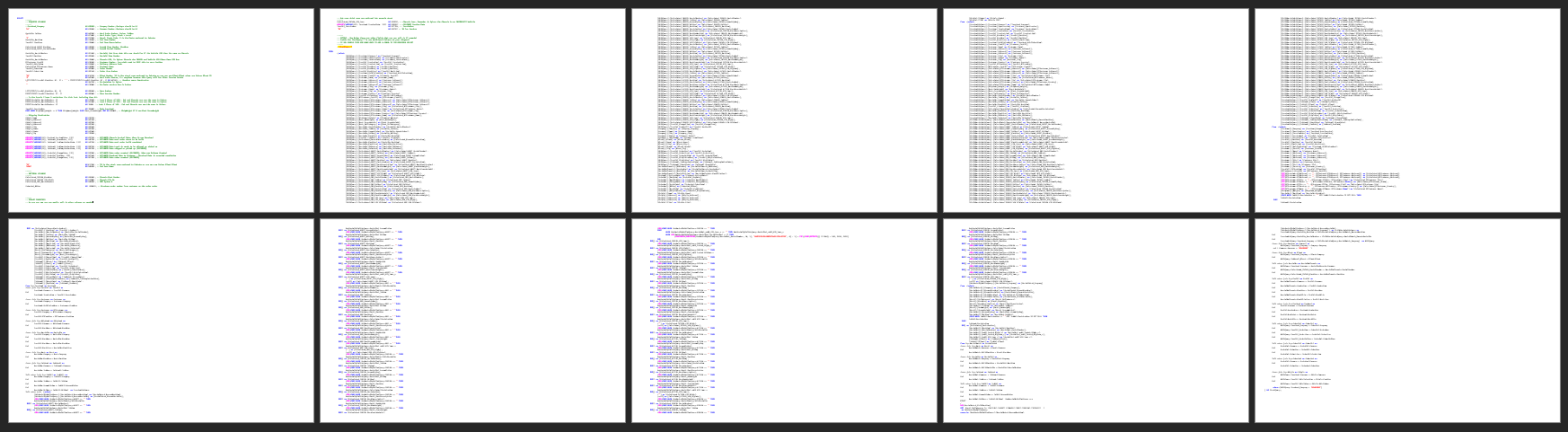

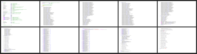

I dont have a good way to show this… But I have one BAQ Query, completely built using the BAQ Designer that spans multiple pages when pasted into Word.

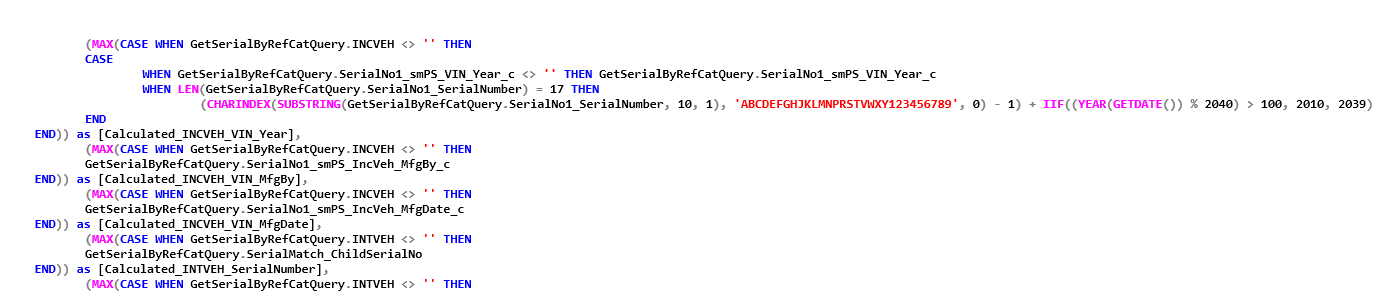

Including a VIN Year Decoder:
I have more complex ones, they run all under < 10 seconds. Definitely alot of Respect for the folks at Epicor who built the BAQ Designer.
There are alot of tricks folks don’t know about that the BAQ Designer lets you do. Recursive CTEs…
Being able to do Expressions in the JOIN or even running a SubQuery etc…

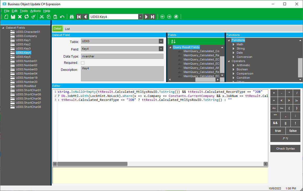

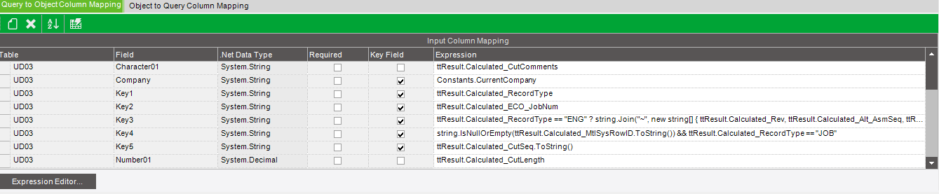

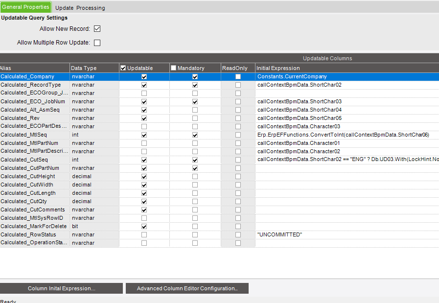

Let’s not forget Updatable BAQs, you can mess with the BPMs in the UBAQ or you can use Expressions properly :slight_smile:
Who said Dashboards cant send over RowMod and handle Delete :balloon:
