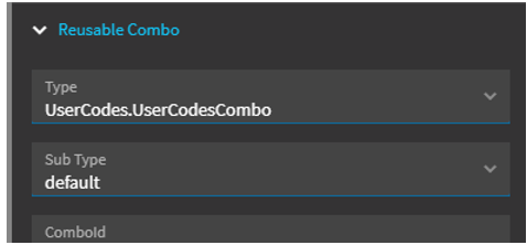

Once you have added the combo and bound it in the application studio.
Set the Resuable Combo type to ‘UserCodes.UserCodesCombo’ ad the SUb Type to Default.

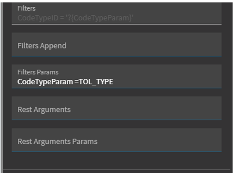

Then scroll down to the Filter Parameters
Set the Filter Params to 'CodeTypeParam =UDCODETYPE
