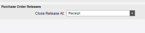

We’re on 10.2, has anyone experienced any issues with POs not closing despite all the lines being received complete. We have correctly enabled this setting but sometimes, it seems to be when goods are received on different receipt entries, the PO does not automatically close.

To confirm, you are saying the company config is set to close a PO release at receipt correct?

Hi Mike,
Yes, that is the setting we have enabled.
