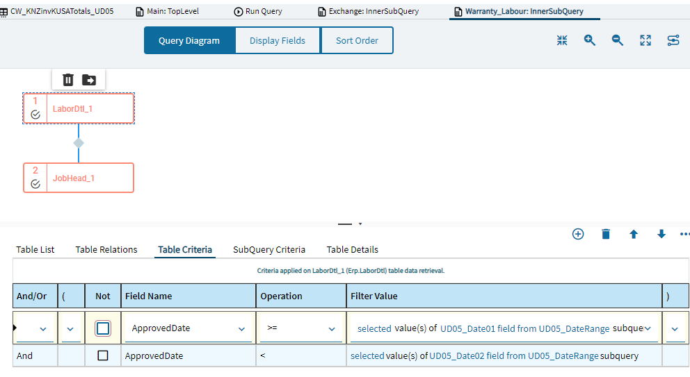

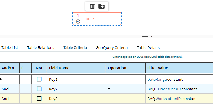

Just took a BAQ I struggled for weeks on, had 5 inner subqueries aggregating numbers from 5 different tables/conditions, and previously used 2 BAQ Params for specify the Period Start and End the aggregations ran over. Every time you did ANYTHING in the dashboard or custom Kinetic App I created with app wizard, you’d get the parmeter input slider appear.
Now just added a DateRange key to UD05 Key1, add another UD05 innersubquery to the report, and and doing my range filtering so:
The UD05_DateRange subquery:

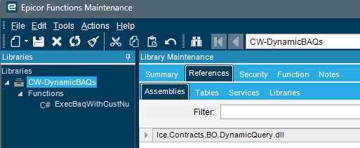

Hi @ridgea I tried to follow your model, simplified for now to just pass a single parameter (CustNum) but tripped at entering the code, its giving me syntax errors (this my first attempt at any code in epicor btw, forgive me if I missed something obvious):
UPDATE, nevermind found it I think:
original errors:
System.Drawing.Bitmap CS0234 The type or namespace name ‘DynamicQuerySvcContract’ does not exist in the namespace ‘Ice.Contracts’ (are you missing an assembly reference?)
System.Drawing.Bitmap CS0234 The type or namespace name ‘QueryExecutionTableset’ does not exist in the namespace ‘Ice.Tablesets’ (are you missing an assembly reference?)
System.Drawing.Bitmap CS0246 The type or namespace name ‘QueryExecutionTableset’ could not be found (are you missing a using directive or an assembly reference?)
System.Drawing.Bitmap CS0246 The type or namespace name ‘ExecutionParameterRow’ could not be found (are you missing a using directive or an assembly reference?)

CallService<Ice.Contracts.DynamicQuerySvcContract>(dQ =>
  // Create a new instance of QueryExecutionTableset
  Ice.Tablesets.QueryExecutionTableset dsQueryExecution = new QueryExecutionTableset();
  // Create a new ExecutionParameterRow for the 'CustNum' parameter
  ExecutionParameterRow drRow = null;
  drRow = new ExecutionParameterRow();
  drRow.ParameterID = "CustNum";
  drRow.ParameterValue = this.CustNum;
  drRow.ValueType = "nvarchar";
  drRow.IsEmpty = String.IsNullOrEmpty(this.CustNum);
  drRow.RowMod = "A";
  drRow.SysRowID = new Guid();
  // Add the 'CustNum' parameter to dsQueryExecution
  dsQueryExecution.ExecutionParameter.Add(drRow);
  // Execute the query using the BaqID and dsQueryExecution
  this.returnObj = dQ.ExecuteByID(this.BaqID, dsQueryExecution);

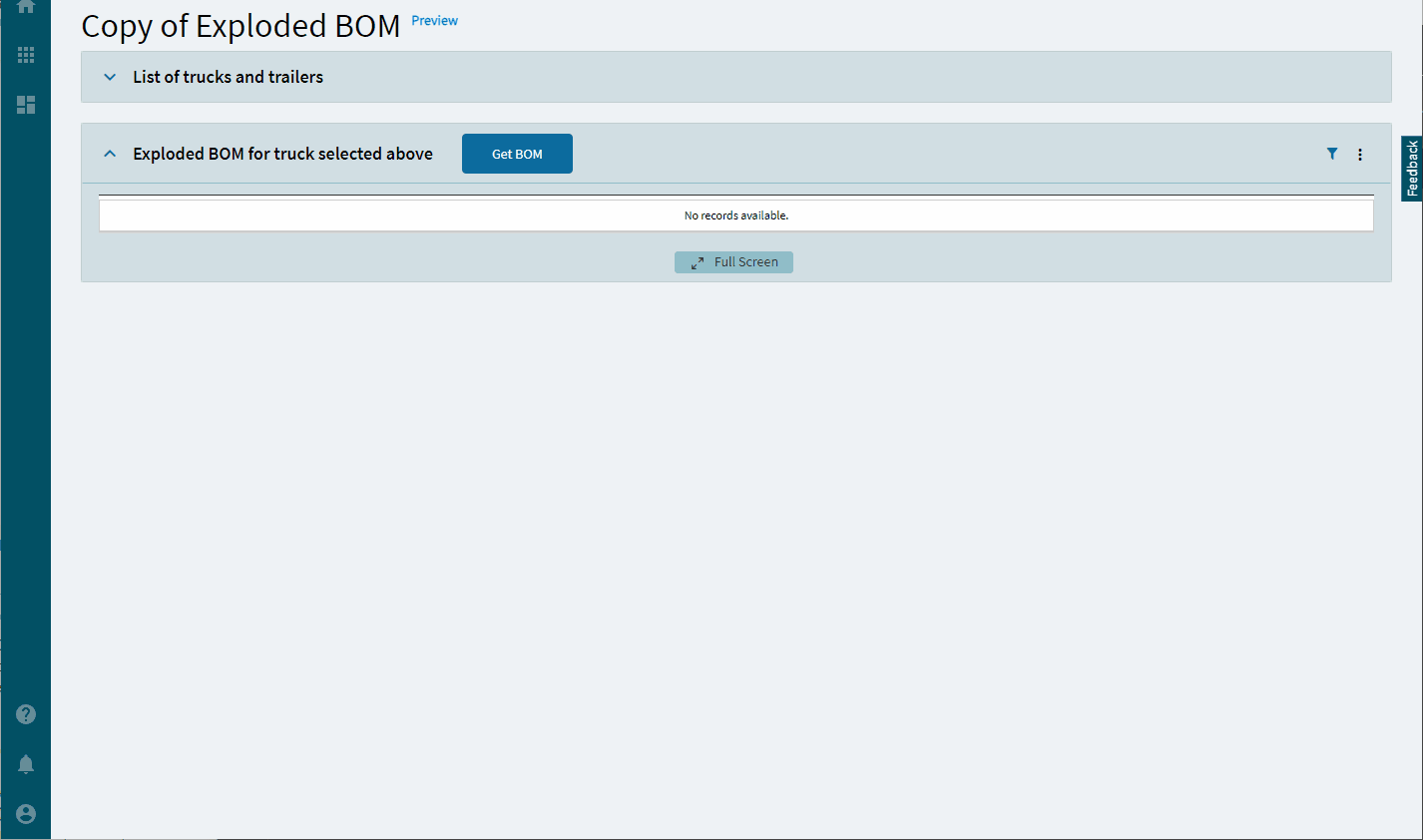

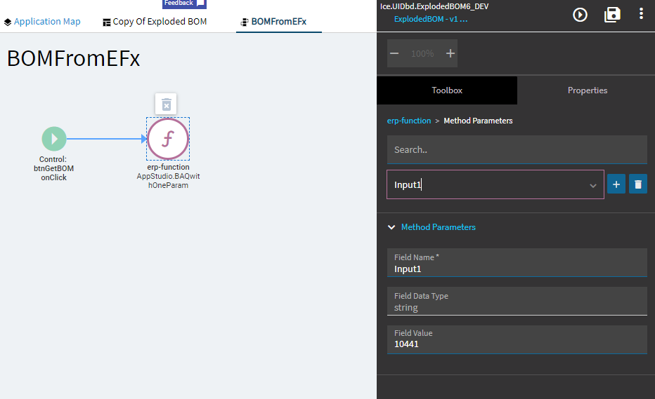

@ridgea Can you explain this a little more? Because I am still getting the slideout.
I followed your PDF here, and I did indeed succeed in getting the BAQ to run without me (the human user) needing to enter anything. But the slideout still appears when I expand un unrelated panel card. See GIF below.
BAQparamWindow
For the event, I actually hard-coded the input to the BAQ (well, the EFx that then runs the BAQ), but I mean, I could tie it to an input box or something.

Interesting, I assume you are ultimately trying to 1. Get a list of trucks / trailers then 2. Run you exploded BOM for that particular truck?
Also did you add the parametrized BAQ in when initially creating the dashboard or did you add it via Application studio ?
No problem.
Yes, exactly.
Added later. It started with just the “List of trucks and trailers” BAQ, which I published. Then I went into app studio to add the parameterized BAQ.
That’s cool, I just wanted to check, is the top panel a BAQ with a parameter ?
I’ve re-looking at it in dev and i can’t seem to replicate the issue to see what could be causing it.
Feel free to pack it up in a solution and ill see if i can take a look when i get a spare 5.
