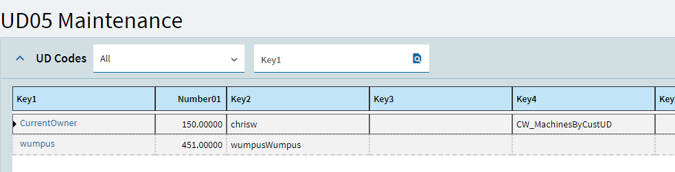

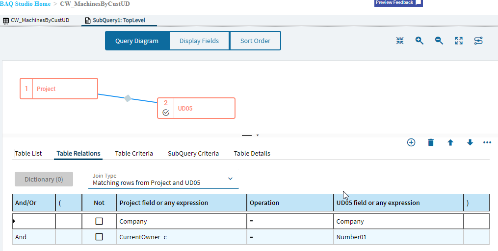

I have a spare UD table, UD05. My first BAQ I am testing it with is to be called from Customer Entry and its derivatives, so I’m want to filter within the BAQ down to a particular customer. Here’s my plan:

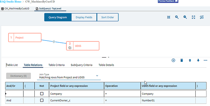

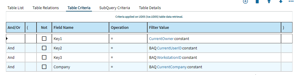

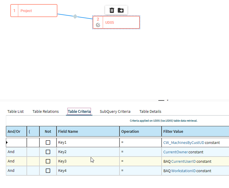

Filter UD05 to select the parameter I want (its value in this case is in Number01):

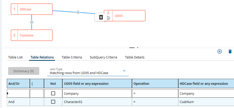

Join my query to it:
I will use 4 keys to identify a row in UD05 where I am passing the parameter.
Key1: The name of the BAQ this parameter is intended for.
Key2: The name of the parameter (in case i am passing multiple parameters)
Key3 and Key4 are the current UserID and WorkstationID to uniquify things and prevent collisions. (SessionID would have been nicer but can’t seem to access it as a special constant, but I think the userid/workstaionID should be sufficient to avoid parameter collisions between concurrent calls).
(I might rejig this and move BAQ name to to key 4 and the existing keys 2-4 up one, so that the BAQ name is optional- often have several BAQs firing in sequence all filtered off the same “parameter value(s)”, would be better then to set it once)
On the app studio side, before i call the baq-get, I will update-or-insert based on the 4 keys, and update in this case the Number01 field to the CustNum I require data for, and post and then I’m good to go and update from the baq(s).
Optionally at the end could delete the added row but probably not really necessary… UD05 will grow but not super fast and at least have some traceback, and can schedule it to be emptied weekly or something.

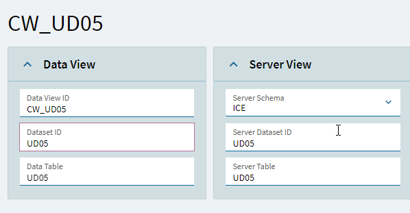

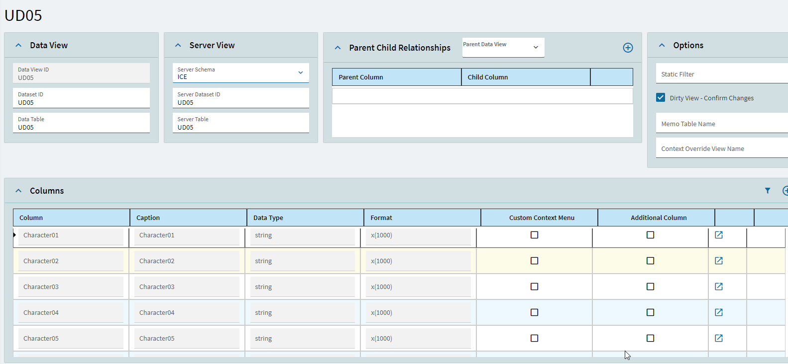

Anyway, the UD05 table is set to go, the baq looks to be working as expected ( I can manually populate UD05 with a suitable “key” to return a CustNum) , but I have fallen at the first hurdle in application studio: I cannot link a dataview to my UD table, and haven’t managed to find any examples here of it being done. Here’s what i have tried, but no columns appear:

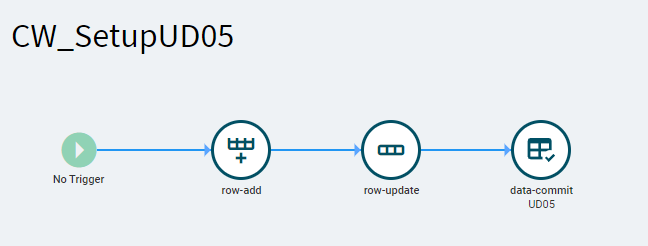

I was planning on doing this to my UD05 dataview:
  • a row-find
  • then either a row-add or a row-update,
  • then a data-commit
then my baq-get.

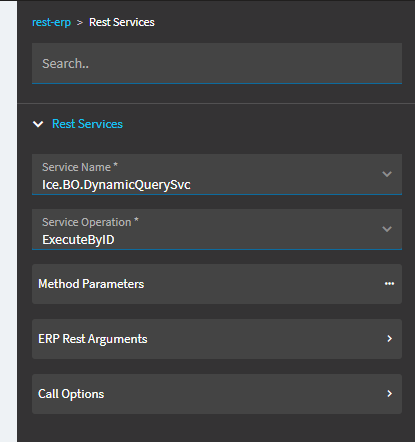

Or maybe I can skip the dataview and do it with a rest-erp call? something like…

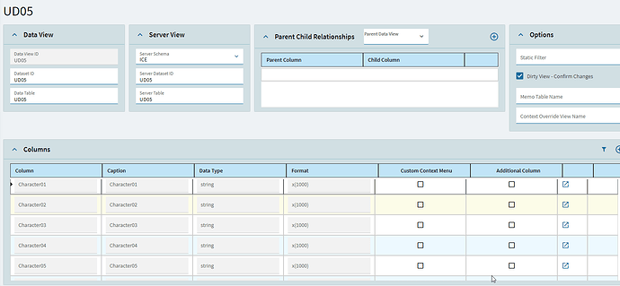

UPDATE suddenly the dataview “took”, and loaded the columns:
Don’t know how or why, but hey I’ll take a win where I can.

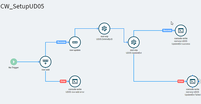

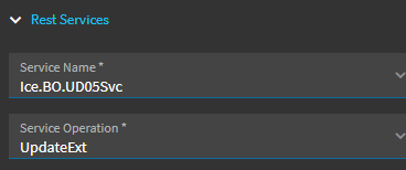

So then I thought I could sidestep the erp-rest calls (which I have struggled with refer Epicor Kinetic- rest-erp - #14 by Chrisw), and just do something along the lines of:

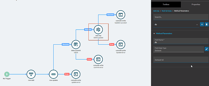

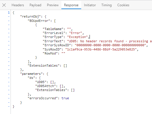

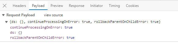

Looks OK, no errors, but nothing is written to the database.

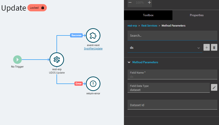

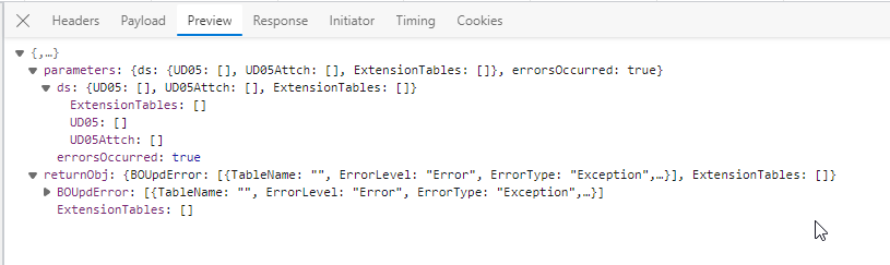

I then tried adding an erp-update afterwards (I looked into my UD05 menu in application studio and thats how it saves) but then get :woozy_face:

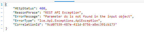

So fair enough, there should be something in the payload to commit.
But when I look at the system generated Update call its params look the same as mine:
Theirs:
Mine:

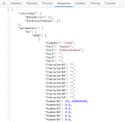

You need to set your DataSetID to the one you have.

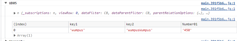

Thanks, some progress, but none of my added data still in the payload:
ctrl alt V on the dataview:
Maybe the commit is marking it as not dirty so not saving anything?
(and any pointers to anything discussing dataviews vs datasets, suspect dataview is a row in a dataset?)
Nope: getting rid of commit didn’t help

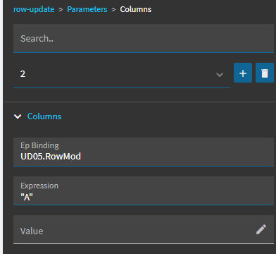

set the rowmod in row-update

Wasn’t familiar with rowmod, some googling suggested it should be set to ‘A’ (for “add”?), so I did that in the update:
I changed the case as that’s what googling suggested, but the fact it doesn’t show up in the dataview columns I thought it would barf; it didn’t but still me dataview refuses to save, still empty payload as above.

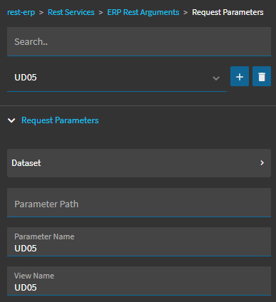

Hold the phone!
and
(doing a little dance)
Needed this in the Rest Arguments
Needs a bit more work but Silent BAQ Parameter Passing is working :grinning:

The BAQ server side filtering via the UD05 join :
Using the Character01 to store the integer CustNum as using Number01 was 100% reliable in the Kinetic BAQ designer, but only worked 50% of the time with ExecuteBAQ calls, some sort of float rounding I guess?
(Can also filter on key4 as a “function filter” such as the target BAQ name, but leaving it open for now. I should have named my parameter (Key1) CustNum not CurrentOwner too, better decsribes what it is esp in the case context)

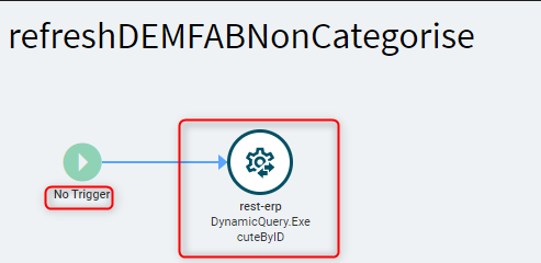

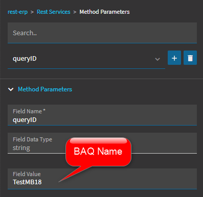

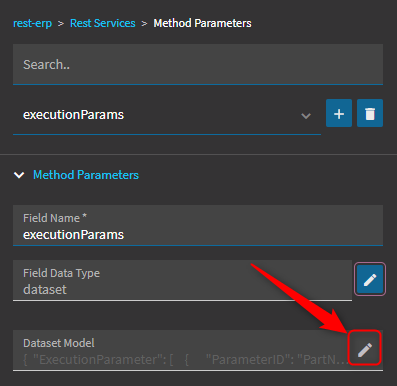

Maybe I don’t understand your requirement, I feel there is a simpler way to do this, as explained in this post.
Long story short:

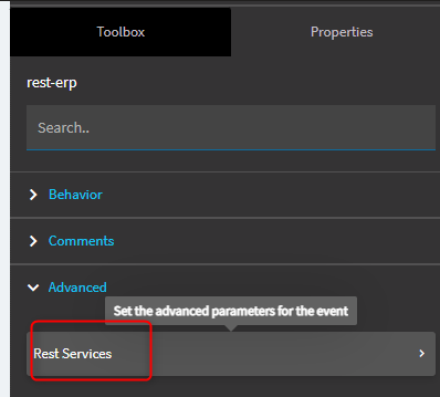

Use the rest-erp widget
Configure the rest service

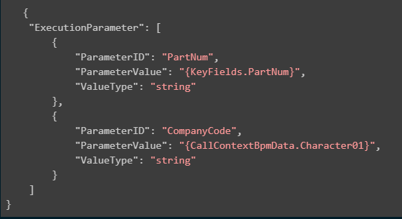

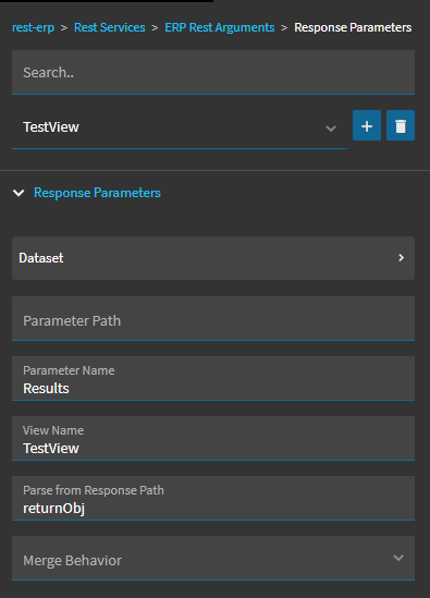

Here is where you setup your BAQ parameters
Json syntax, to pass multiple parameters (as explained in the linked post above)
Define in which dataView the BAQ result will be saved
That is a lot simpler… I had been searching for a way to pass params to baqs without the slideout parameter panels appearing.
However: If I have a grid linked to a baq, won’t the native mechanisms still fire and pop up the parameter entry dialogs?
As soon as I put baq parameters in, those parameter entry dialogs start sliding in and i really don’t want them!
So this was a way to communicate virtual parameters to the baq without using the built in parameters, which carry the burden of unwanted dialogs.
