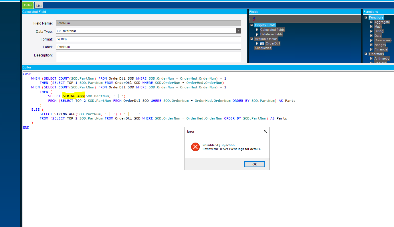

still gives error
Y’all, I’m pretty sure you can’t write new SQL queries in calculated fields, can you???
@Kshitij is trying to write a whole different query in the calculated field.

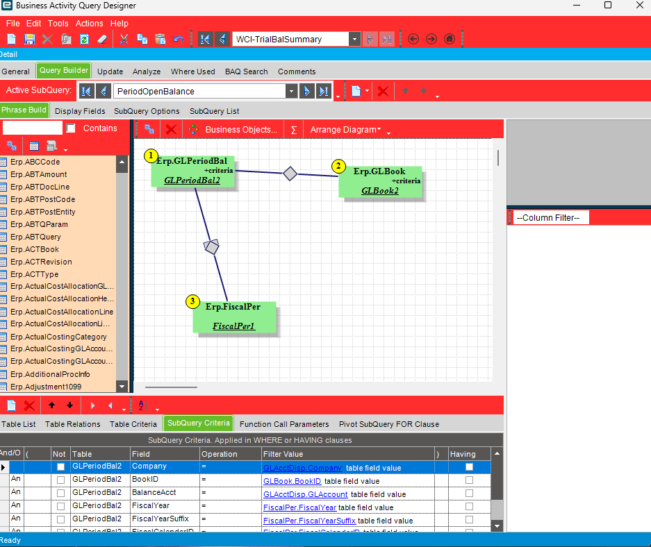

@Kshitij, you need to use subqueries and CTE functionality within the BAQ framework to do what you’re doing, not write it out as SQL.
You have to make a Sub-Query, then supply in the Sub-Query SubQuery Criteria, then instead of using it in your Main Query as a JOIN, you can use it in a Calculated field with {SubQueryNameHere}
Epicor will then insert that Sub-Query as a Sub-Select into that field wherever {SubQueryNameHere} is used, you can even use it in Expressions on JOINs etc…

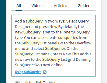

@Kshitij do you have access to any of the Epicor Documentation? I think they go through a CTE BAQ or subqueries if I am not mistaken.
You can search it in your kinetic help

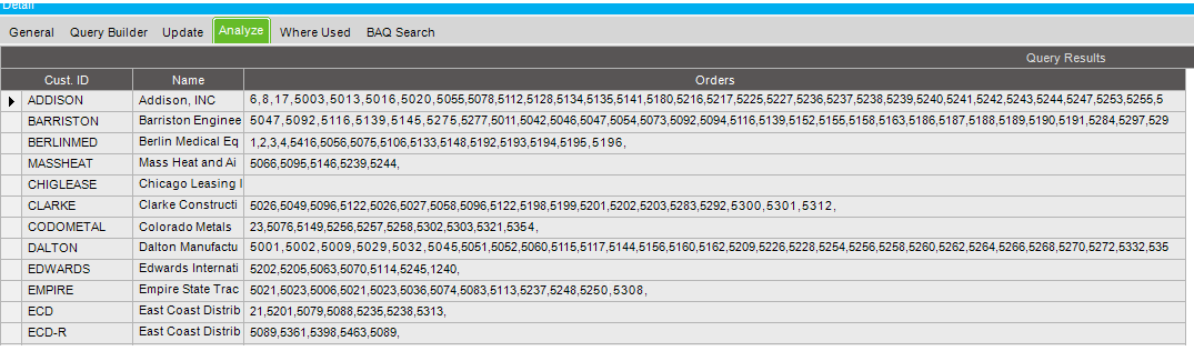

I am trying to achieve some thing like this:
where i can concatenate OrderNums together in one column.

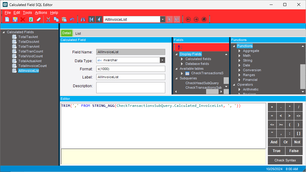

so if you have that BAQ working, then replace the STUFF function you’re using with string agg in that BAQ
Make this a string_agg function not FOR XML.
You can ask an LLM (chatGPT, whatever you want) to take that and make it a string_agg function instead.
Example
