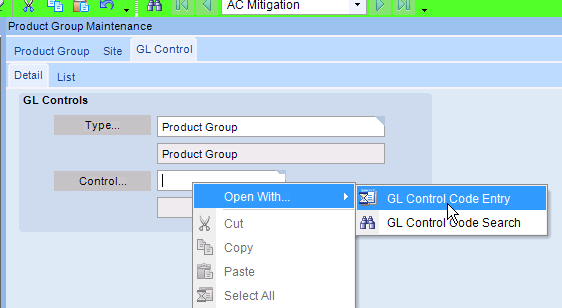

  1. Launch Prod Group maintenance and load the PG you need the GL Control for
  2. Select File -> New -> GL Control
  3. On the GL Control \ Detail tab, Search for Type Product Group (or type the words ā€œProduct Groupā€ in for the Type)
  4. Right Click in the Control Field and select Open with … -> GL Control Entry
  5. Enter a code for this GL Control. (I use the ProdCode prefixed with ā€œPG-ā€) and a Description

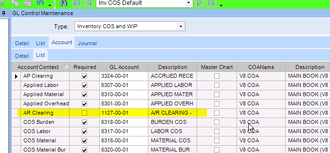

The GL Control Type ā€œInventory COS and WIPā€ has an override for AR Clearing:
But I don’t know if that can be attached to the Product Group.
