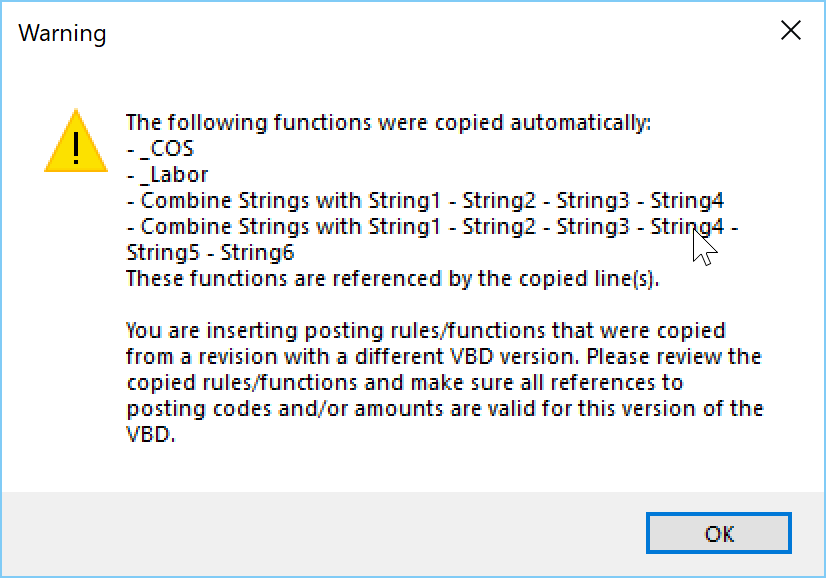

Imagine my surprise when I was working on eliminating “Periodic Posting Process” by importing in a rule that was done in an earlier version and copying a section of code into a new revision.
First I was prompted that my copied lines had functions that needed to brought in to, (so they were copied)
