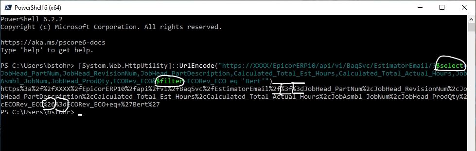

It seems to me that the Swagger Url is already partially encoded/decoded.
https://XXXX/EpicorERP10/api/v1/BaqSvc/EstimatorEmail/?**%24**filter=ECORev_ECO%20eq%20’Bert’
When it has already changed $ to %24. And then THAT gets sent to the UrlEncode utility it goes further into chaos because it changes the ā€œ%ā€ of %24 through another round of decoding that results in ā€œ%2524ā€. I don’t think that helps get a usable result in the Invoke method.
I feel like I’m way in the weeds now…
Try calling the UrlDecode first (same example page) so that you remove any encoding that’s coming in and then do the Encode afterwards.

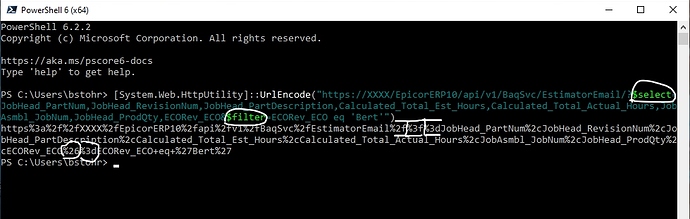

So, an interesting thing happens on the way back to the Encoder. The $select and $filter get recognized and ignored. This renders the URL unusable. The result skips right over the green highlighted text and moves on to the next character.
Ugh…
Seems I’ve hit the overlap between the Powershell ā€œuses $ for the variableā€ and ignores it and REST ā€œuses $ for a commandā€
Sorry this is such a PITA, but for a quick fix, just do a string replace to add your ā€˜$’ back.
But it drops the words ā€œselectā€ and ā€œfilterā€, too.That’s what I’m attempting to show in the screen shot.
I think power shell is seeing those as variables and replacing them with their content (which is a null value).
