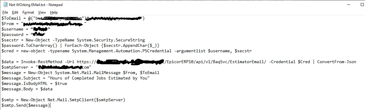

Here’s my attempts and results:

I’ve adjusted the end of my Invoke to match yours:
‘api/v1/BaqSvc/EstimatorEmail/ -Credential $Cred -ContentType “Application/Json”’
Then I need to make the $message.Body like this?
“$message.Body = $data.value”
My test returns a new email with a completely blank Body.

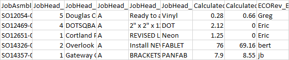

I see that I can get the data into a CSV file following your example.
Is that the viable solution? I’m asked to fill the body of the email. Is that can of worms I’m not aware of?
image JobAsmbl_JobNum JobHead_ProdQty JobHead_PartNum JobHead_RevisionNum JobHead_PartDescription JobHead_ProdCode Calculated_Total_Est_Hours Calculated_Total_Actual_Hours ECORev_ECO
SO12054-002-10 5 Douglas County Courthouse DPV Name Insert A Ready to apply digitally printed vinyl graphic. Vinyl 0.28 0.66 Greg
SO12469-038-1 4 DOTSQBAP A 2" x 2" x 12’ square DOT post with 2.25" x 2.25" x 3’ breakaway base post with breakaway hardware. Post price includes cast hardware for double street blade on top DOT 2.12 0 Eric
SO12651-002-0 1 Cortland Partners Corp - Wall 6 - Led test A “REVISED LED -
lighting and components required to custom color the lensed lighting at the corporate office accent wall to achieve the color effect closer to the PMS value.” Neon 1.25 0 Eric
SO14326-007-0 2 Overlook Parkway Monument Rework A Install NEW channel letters onto a 3/16" painted aluminum cover to go over existing concrete base. FABLET 76 69.16 bert
SO14357-024-0 1 Gateway Center Arena - Other 1 - Brackets A BRACKETS -(10) aluminum clips to be painted and mounted to existing sign. PANFAB 7.9 8.55 jb

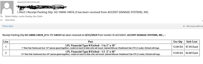

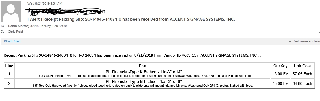

The problem is that I’ve duplicated a formatted email body from Epicor data for Receipts (from a post from @hkeric.wci ) and they expect something similar for this email.
@hkeric.wci’s cool PO Email

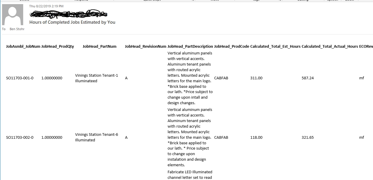

My adaptation results in this:
Everybody loves it. F*ck me for trying too hard!
So how screwed am I? Can I unpack that PowerShell object to a formatted table in an email?

You’re already setting your email to be html, so you can loop through the results and build an html table with your results. $data.value is an array of objects. For each object in the array, create a table row and table data cells for the values you need displayed. You’ll have to look up the syntax for looping in powershell. I’m not fluent in powershell syntax, but I can usually get it to work with a bit of trial and error, and I’m sure you’ll be able to, too.

It seems adding the BOLD bit to the end of my “Invoke…” method has made the world become friendlier:
EpicorERP10/api/v1/BaqSvc/EstimatorEmail/ -Credential $Cred -ContentType “Application/Json; charset=UTF-8”
So here is the working version:
