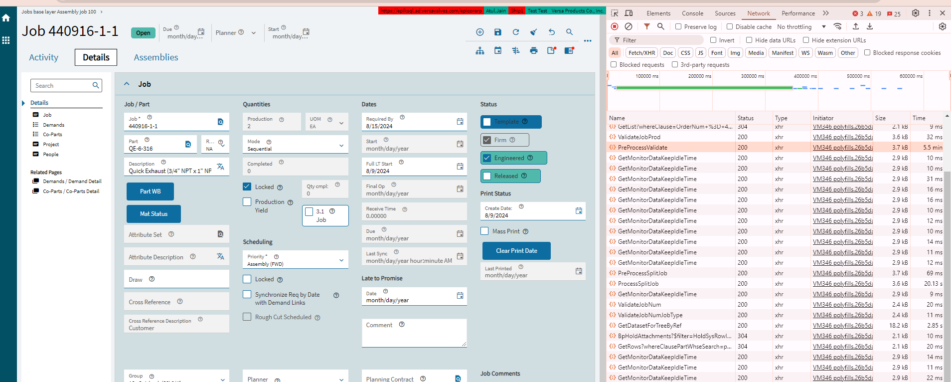

Pre Process validate on split job takes over 5mins
PreProcessValidate takes over 5 mins when we split a job in kinetic,
Can we diagnose and reduce the time?

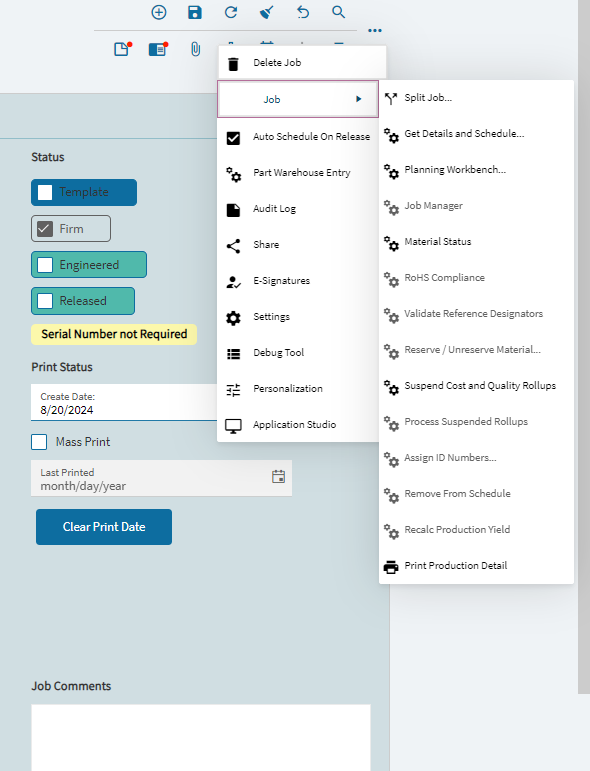

Try removing from the schedule before splitting, so it is only working materials and not also operations.
Where is that option?
Thanks.
job entry actions.
@gpayne i checked, its not on schedule before splitting the job.
Ok, my last grasp is to try the split in the classic client to see if is something in the new UX that is different.
