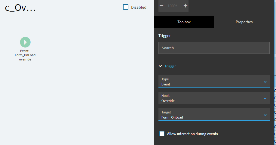

Is there a way to stop a dashboard from auto returning results upon initial load?
I want users to enter a filter/tracker value first before anything loads in the grid. I tried created an Override on Form_OnLoad, but the grid still populates automatically.

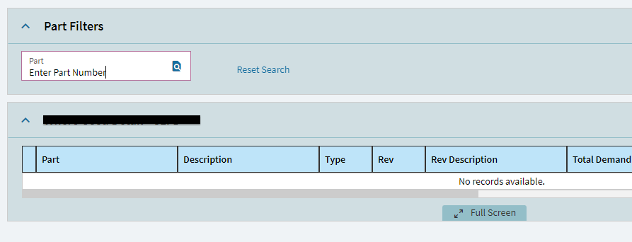

In this instanace, I used row-update on the Form_OnLoad that forces a value into my filter. This at least stops the inital load.

In the provider model of your grid you would have put a ? Or ?? In front of the Part Number filter field.
I can never remember which is which of by heart but if you put ? Change it to ?? And if you put ?? Change it to ?. As one of them doesn’t make the call if the field is blank / null.
Single question mark means it has to have something to run.
Double question marks means it will run regardless and send an empty value.
Thats it. Thanks.
So single for more of a publish and subscribe.
Double for ‘optional’ filters.

The Single ? is actually what I was looking for I think.
Hi, how did you make that filter, linking to a column of the grid? And what widgets you used on button to show the grid with the filters?
