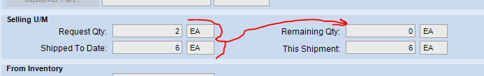

Brian - off the top of my head I believe there was a Remaining Qty field on the shipment entry screen.

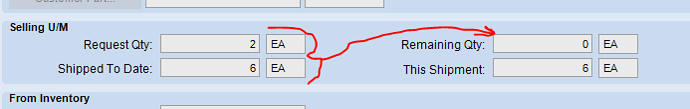

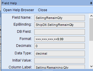

There is a remaining quantity, but it is based on the order release, not the order line and it does not show negative (so IMO it is not correct). Also, this is NOT a database field.

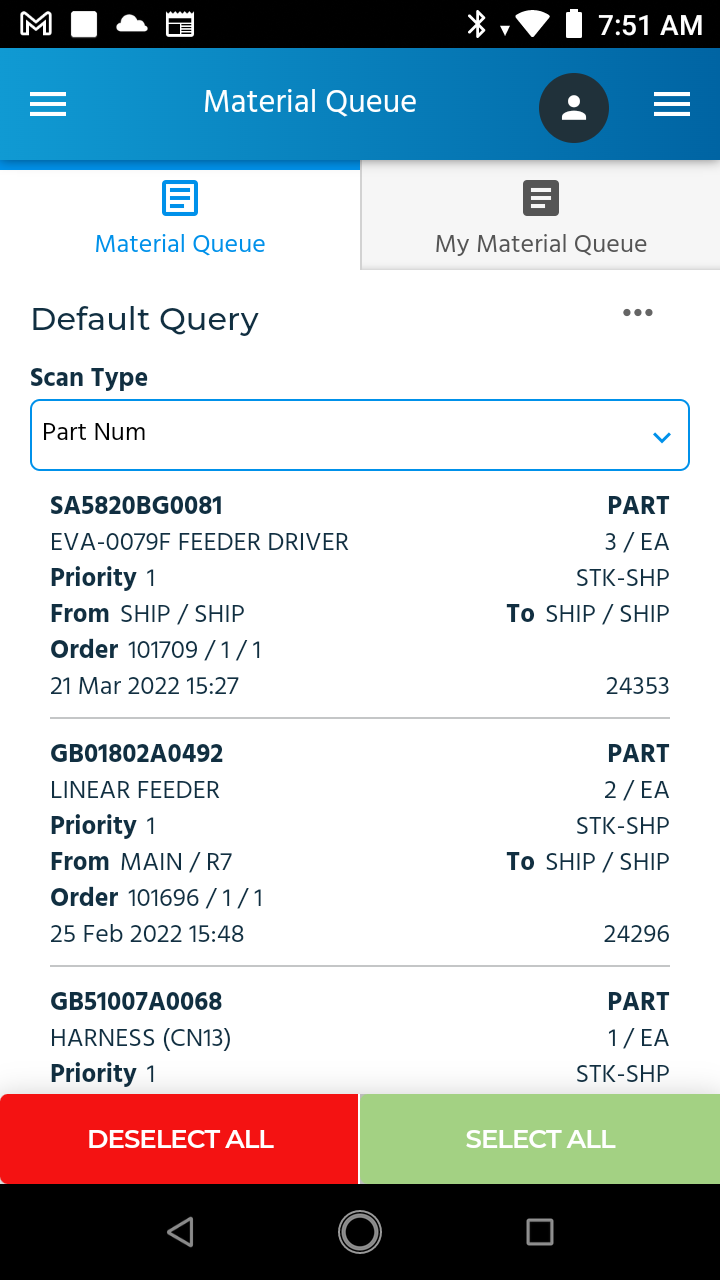

Here is what we see on the Material Queue on the handheld:

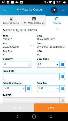

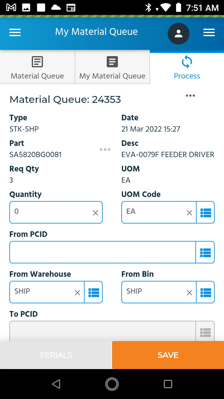

The picker selects the item, then the item goes to the My Material Queue tab (the picker moves to the My Material queue tab and selects the item):

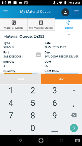

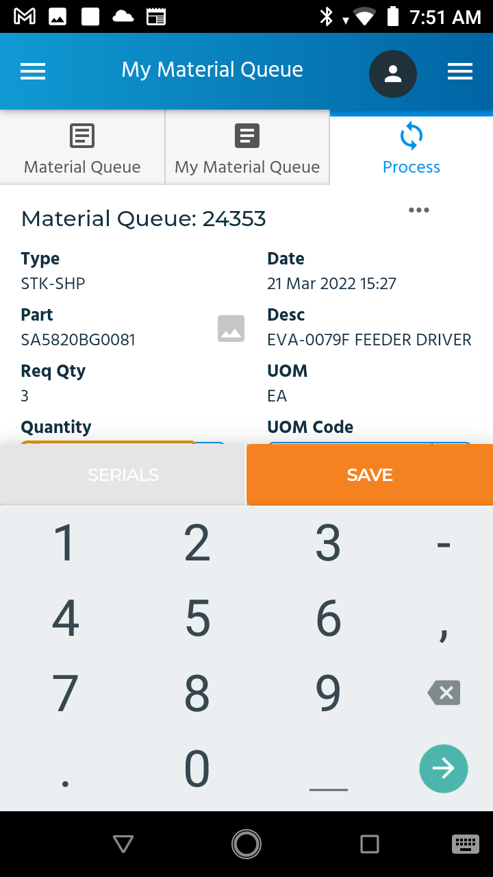

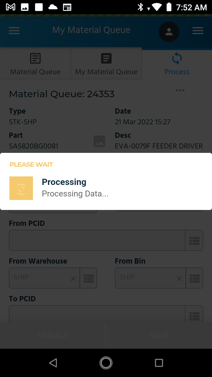

The requested quantity is shown, and the quantity (picked) is initially set to 0, so you select the Quantity box and the keyboard (10-key numbers) pops up, covering the field you are making entry in:

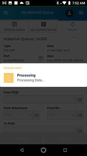

For this example I entered 33 (a typical fat finger error) and it processed just fine:
After that, the shipper goes to Customer Shipment Entry, Actions - Picked Orders, and grabs the item that has been picked. Once it is Picked, it ignores what was reserved and allocated and only looks at the quantity picked and allows you to ship what was picked in quantities greater than requested.

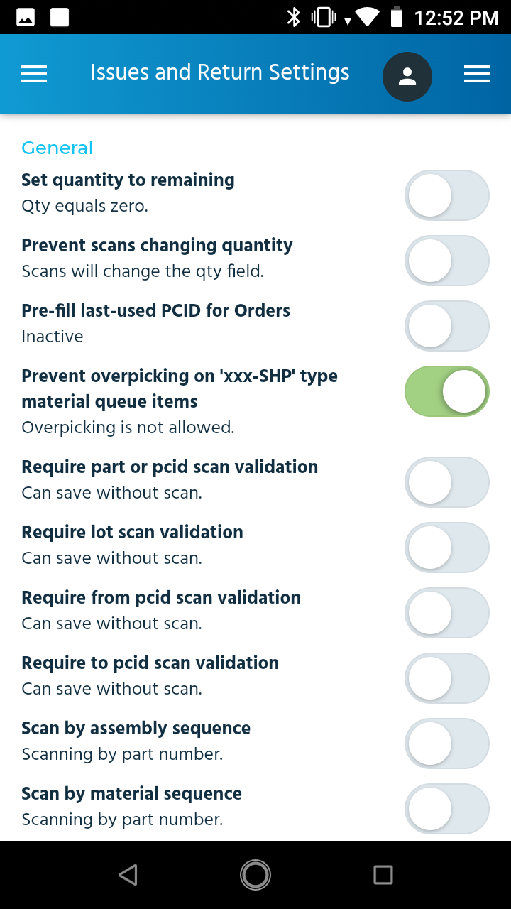

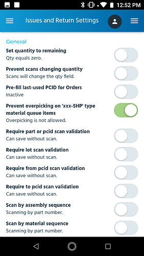

@BKen there is a setting in the shipping section of the app that says, “Over Packing Control Mode” and then they have: Stop, Warn, None as options.
Does that not trigger in this situation if you chose “Stop?”
Utah,
Nope, that did not do it. …but it got me looking around (so thank you SO much for pointing me in the right direction).
Under settings, Issues and Return (settings), you see the following screens:

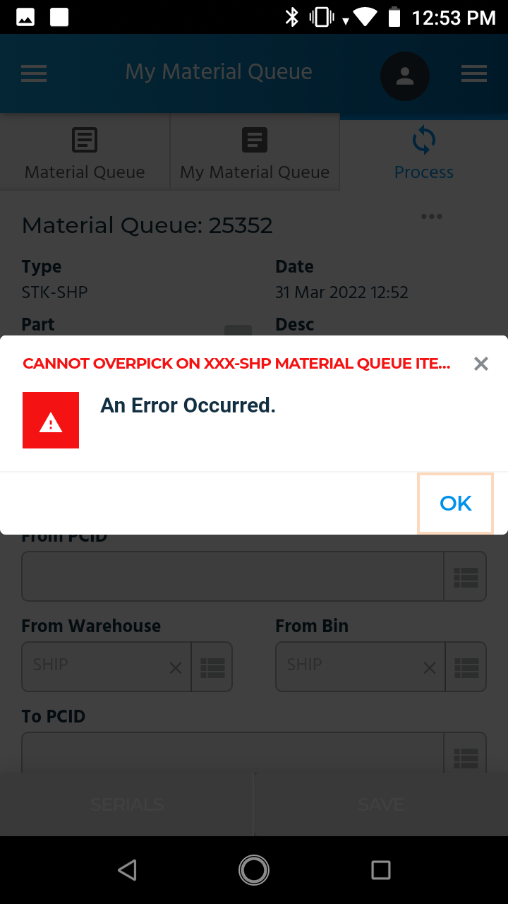

Now, when I try to over pick I get this:
So user error on my part. I am marking this one solved and will give Utah credit.
