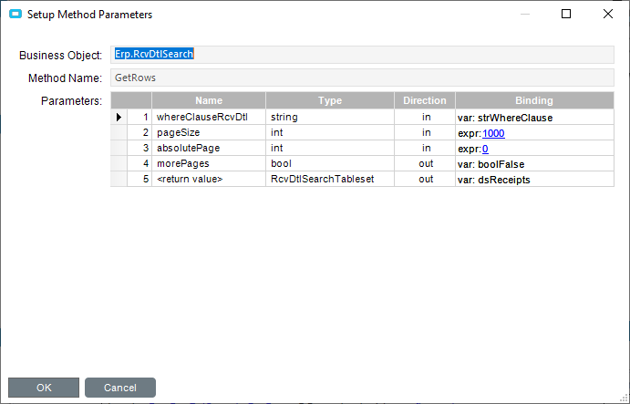

Thus far I have succeeded in
RcvDtlSearch.GetRows for the given PO/Line/Rel
Resulting dataset is variable that I named dsReceipts
Made an integer variable that is set to dsReceipts.RcvDtl.Count
So that’s cool - you can do an aggregate (kind of; not really) in a simple variable without a loop or anything. Took me a while to work out the syntax, but I got there.

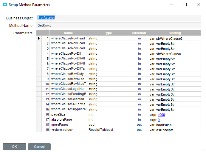

Sure. What I accomplished with summing “OurQty” was the orange column from my first post. That’s actually not useful itself to add the raw numbers in 3 different UOMs. What I need is the sum of the blue column. But - that does not exist. “This Transaction Qty” is not a real field in RcvDtl. So… looks like I will need to get creative.
if ThisTransactionQty is not a database value then it is for sure ttThisTransactionQty within this data set, so use it straight a way to do your comparison, i have done something similar with Quote Break Qty Cost values.
Ooh, interesting. That raises some questions, though.
So, this compiles (or whatever) but returns zero (in sum, anyway).
Just to clarify here, this is not itself a BPM. It’s an Epicor Function, and I am testing it in hopes of using it in a Data Directive (BPM).
So perhaps that is why I get zero, because I am not transacting?
But I don’t think I buy that, because I am indeed invoking the BO. And Receipt Tracker, for example, shows This Transaction Qty and it is certainly not mid-transaction.
So, I had been using the BO of RcvDtlSearch (seemed like it would be less bloated), but in fact I neededReceiptinstead, in order to get that “transaction” quantity.

@A.Baeisa Well, this leg of it is resolved, definitely, thanks to you.
Now I’m on to the check against ordered quantity (is tran qty > ordered qty), and is this a delete or are they modifying an existing receipt or is it a new receipt, etc. Normal problems. I’ll keep updating as I progress.
