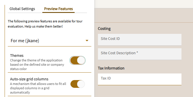

Preview Feature: Site/Company Theming?

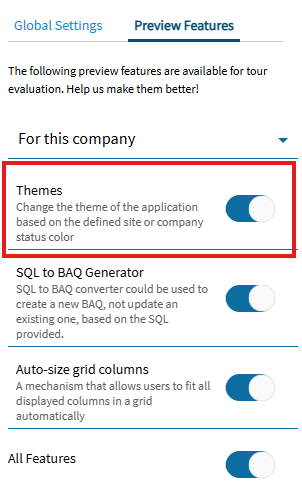

I noticed a “Themes” preview feature come up (2024.2.15)
Does anyone know how this works? I can’t find any information on it in help.
I am single company, single site. But my assumption is that if you change the Company/Site color, it should do “something”.

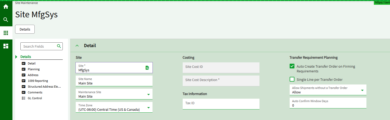

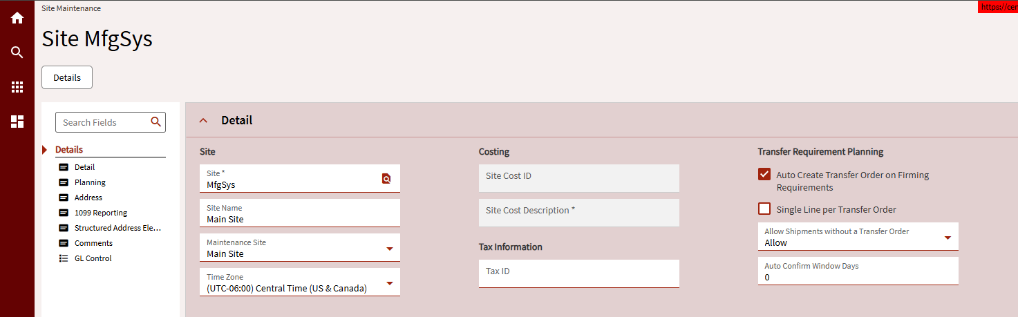

It basically just tints everything on the screen in whatever color you have setup in Site Maintenance. Note the status bar in the top right.
We already have that set and without the preview feature on, it shows the context bar change color. Nothing new here

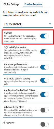

@cory.davis is correct.
OFF
ON

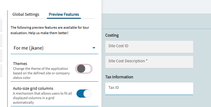

Interesting… Nothing happening for me.
Defined a color in both site/company maintenance. Refreshed page
Maybe the feature is broken in this version.
:man_shrugging:

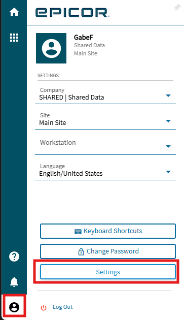

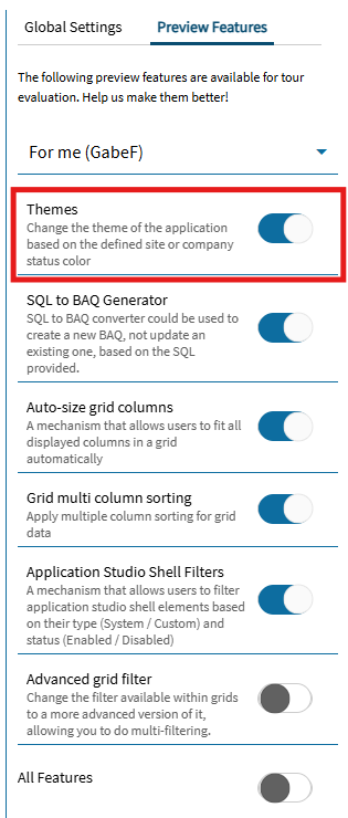

Where is this setting found?

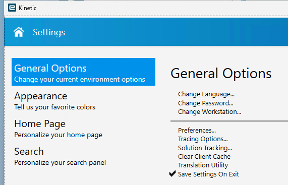

You can but in Site Maintenance,you set the seed color and it decides on the color tones for the rest UI. It’s hot or miss on how well it turns out and seems too limiting to me IMHO.
That settings button takes me to this screen… anyone know what I need to change to get to the new option screen?
–Thanks yes, those options are only available in browser.
Hmm, i’m not sure that it’s possible to get to the Kinetic version of settings from the Smart Client..?
Might need to access that via the browser.
You need to log into Epicor via a web browser not the smart client.
