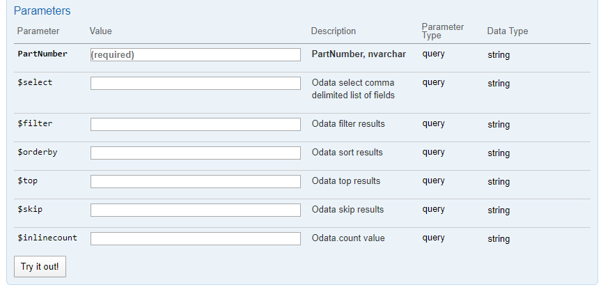

I can’t help you with the task but BAQ parameters do work in Rest.
Create any parameterized BAQ and call it using REST help page.
Holy mackerel that’s crazy simple!
I feel so silly for not even trying it. I just assumed there was some ridiculous setup involved.
