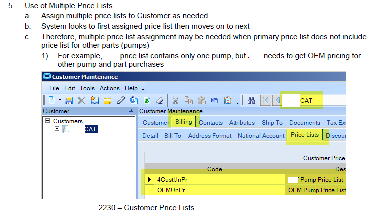

One other way I can think of would be to use multiple price lists. This would not help you in regards to “not have to rework price lists” conundrum, however. Here in our price list procedure, we have details on using multiple price lists on customers sometimes:
Nancy
