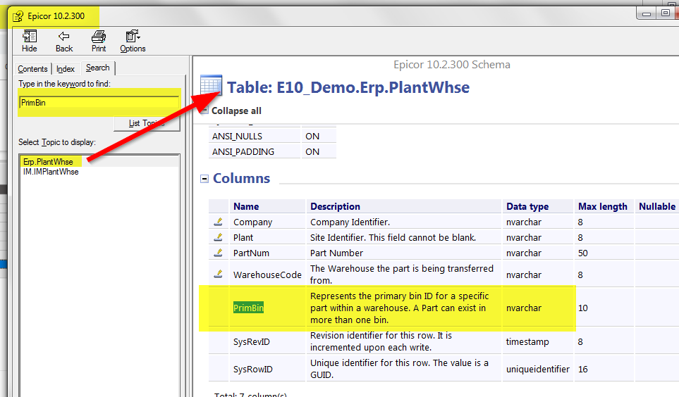

Just curious … Where (or better yet, How) is the Primary Bin value stored?
It’s in the PlantWhse table.

When I need to find a field, I use the Help File that @hkeric.wci (I think?) made. You can use it like a searchable data dictionary
