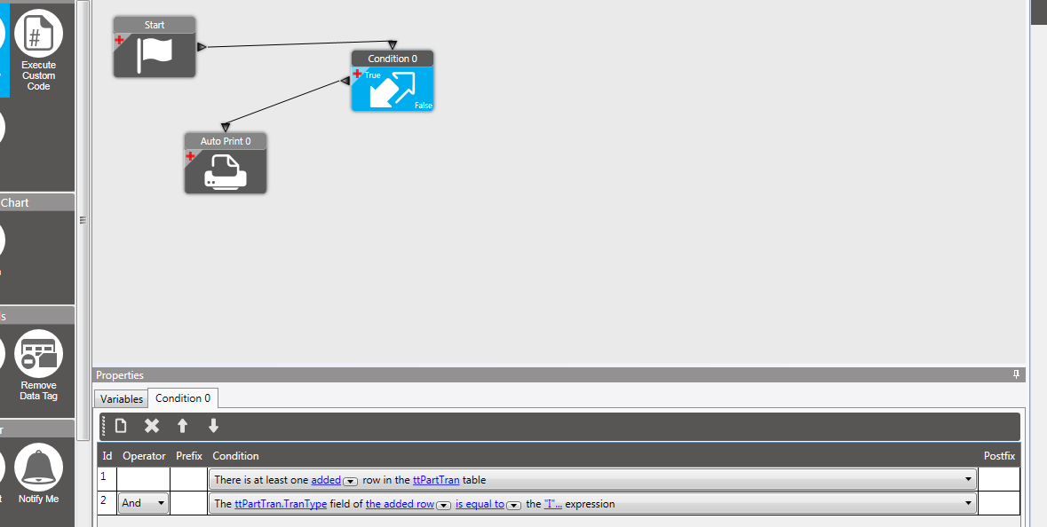

So I am creating a data directives for auto print. I was able to do it for the GenRcpt label when receiving and printing the receiving label. However, I cannot get it to output the output for when doing an issue.
I created a Standard Data Directive that if a row is added to ttPartTran table and the row added have “TranType” equal “I” for issue then auto print. This seem like it should output the txt file for Bartender, but I am not getting anything.
It should output into this folder, but I am not getting anything. Anything else wrong?

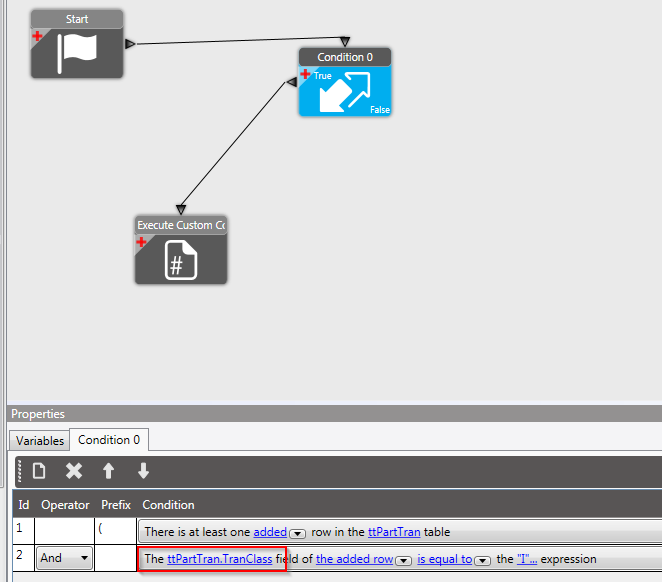

did you try just a simple message box in the BPM to make sure it’s firing?
Never mind, you can’t do that in a standard directive.
Good idea. I created a popup and figured out my issue. Was using the wrong field and should’ve been “TranClass”.
This is what I use for Custom Code to show a pop-up.

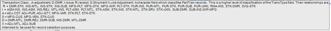

Chai,
I am curious as to what your entire expression includes except the “I…” in the screenshot…
Paul
“I” is it. From the BAQ screen
Ah, thanks! it looked like it cut off more after the “…”
