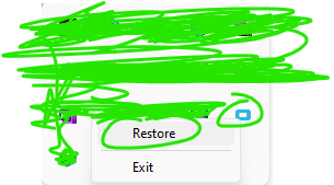

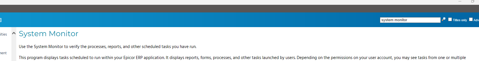

Eliva, open the system monitor in your sys task tray:
Ah, you are in kinetic? “Notifications Bell”
There is still a system monitor there and you should see a column in the history tasks that says status and it should say ERROR in your case, but if it says COMPLETE then I am not sure.

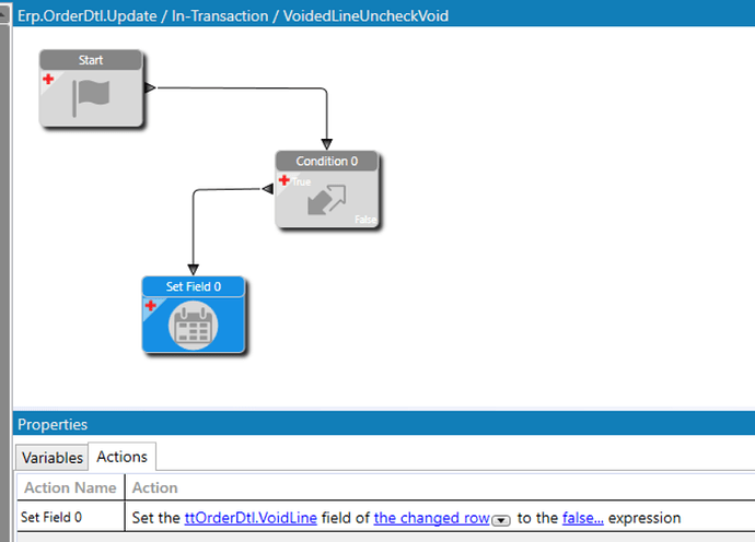

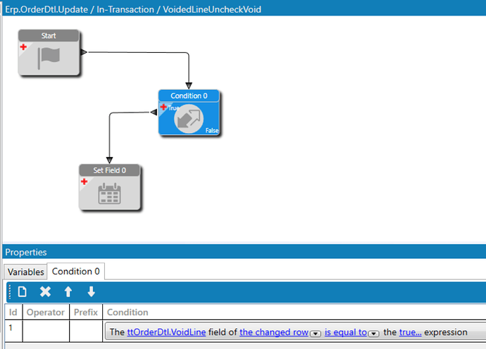

I just “fixed” this in my system using a BPM (as suggested here by @DaveOlender)
Even if I can print other SOs?. Because the problem are only with certain old Sales Orders
Here’s the BPM details:
This just forces the VoidLine checkbox to always be false.
With that BPM in place… test it out:
  • Open a Void Order
  • Overflow menu > Reopen Order (this will un-void the order)
  • Go to the Line Details > Overflow Menu > Reopen Line (this will un-void the line)
  • Overflow Menu > Close Line (this typically would VOID the line… but the BPM will now allow the line to close, but will keep the VoidLine checkbox unchecked).
This Sales Order should now print.

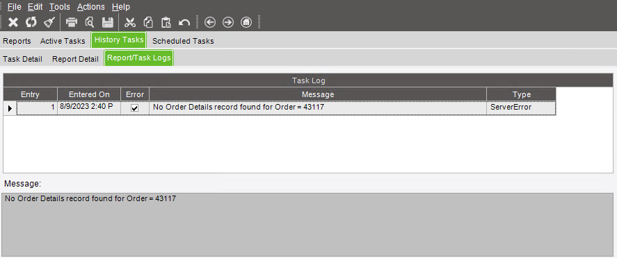

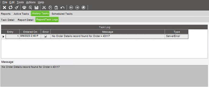

@dcamlin is stating that voided lines can be a problem. you need to use the system monitor to tell you what the problem is, have you opened the system monitor to look at the task?
Oh, yes! I hadn´t seen this before. And there is an ERROR : "No Order Details record found for Order = 2 "
