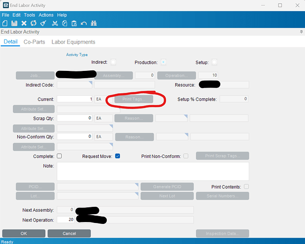

I have a question about how to customize the Print Tags option in Epicor MES. We want to use a custom format, but I would like to know where I can find the default file it uses and where i can make changes to it. If I have to custom code it I will, I just need to know where and how. This pic is our Pilot version so the button doesn’t look active, but the live MES it is active.
Thanks for any help!
If you are asking about the report style, it is called ‘Material Tags’
Just be aware that Material Tags are used in every corner of Epicor and that changes will show up in other places.
There is a long thread here about customizing them.
According to our implementation team, we are not using that Material Tag. I will look at that post. Thank you.

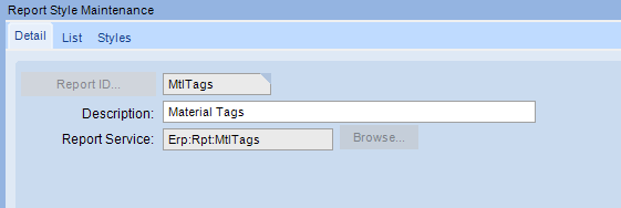

You have to add the table and realtionship in the RDD within kinetic.
Then you need to make sure that RDD is tied to the report style you’re choosing by using report style maintenance.
then you need to make sure that the SQL statement in your SSRS .rdl reflects the changes that you made to the RDD in Kinetic. For example, if you added another table to the RDD (not an extended table) and then you made a relationship, you need to do that same thing in the SQL statement as well as adding the fields you want to your select statement, just as you did in the RDD by selecting to “included” them. In other words, if you added a table and a relationship to the RDD, then you would need to join a table in the SQL statement in the same way. However, if you used extended fields on an existing table in the RDD, then you just need to find the existing table in the SQL statement in the .rdl and find the existing table’s alias (i.e. T1) and then add the field you added to the extended fields in the RDD (i.e. T1.Customer_Name).

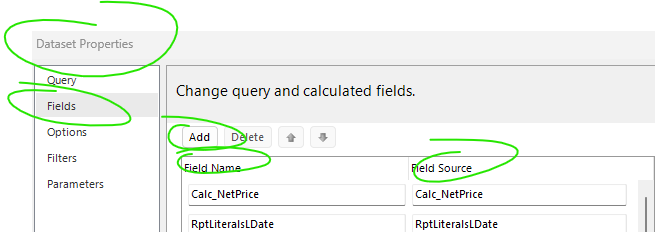

After that, you need to remain in the .rdl and add the fields that you just added to your SQL statement to the “Fields” section of your dataset. You’ll add Customer_Name as the field name and the field source (see photo below of this step)
